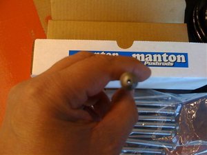

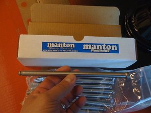

Hughes Solid Flat Tappet HEH 5660as I think it is 256@50/.614 lift intake - 260@50/.626 lift exhaust installed at 103CL and 106LCA Cool Face lifters with oil metering hole, Manton RACING 3/8 Pushrods with 5/16 hardened tips that oil through " The pushrods are not cheap crap and look BAD *** different than your standard pushrod" and HUGHES 1.6 Complete Rocker set up with Banana Shafts and their hold down kit.
Yeah man, I've been to the Manton shop. They made me a set of custom pushrods on a sunday when I juat happen to catch them in the shop. I was in a bind and they hooked me up. Good people.
Are you still running the springs that came with heads? (I'm guessing you are)
Yes they are set up EXACTLY how Brian did them. The only difference is I have the Ported Versions of the INDY/RHS Heads. Thing comes on like a Jumbo Jet torque wise.......no B.S
