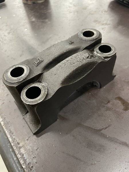

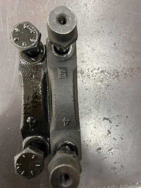

The middle caps are the ones that are heavier on the 340.
The bolts are longer as well.
I have seen this with my own eyes on my own blocks.
Believe what you like.
When I have time I will get pics.
This is a 318 compared to 340. You can tell that the 340 has alot more clamping force and a superior cap and bolt.
360 bolts are the same length as the 340. You can use 318 caps on a 340 as the thrust area is the same.
