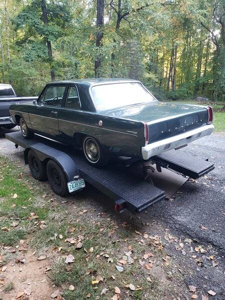

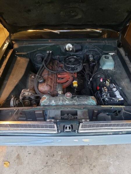

Stumbled across this and brought it home last night.It's been in a barn for the last ten years is all I know about it.Someone made it road worthy recently with new brake lines,battery,power steering hose and fuel filter.I don't even know if it's a 225 or 170 slant.Car is really been untouched with all the factory stuff intact.
These cars are still out there and I wasn't looking.

That's probably a 170 ci.in. in 1967. Three on the tree with 3.23 rear gears more than likely. 7 1/4 rear end.
Nice looking 50 year old car.
Look at the bypass hose in the front that installs between the water pump and cylinder head. If the hose is only about 1" long or so, it's a 170, if it's about 4" long, it's a 225.....or possibly a 198 that's been swapped in. Also, behind and under the alternator, there's a "shelf" of the block that sticks out that has stamped numbers in it. That will have the engine size. Something like "R225 *** or some such. You'll have to scrape it clean to see them, I am sure. Easy to find, just follow the cylinder head down until you find the joint where the head gasket is. The shelf will be sticking out.
Looks like the hose length is 3".Thanks for the info.

So looks like it has a reman engine from someone but don't know who as I found a id plate on the block.The machined surface by the coil id numbers are gone so with the info here given it must have been decked.
Adjusted the valves today because they was so noisy and they must have been double what they should have been.Way better now.
