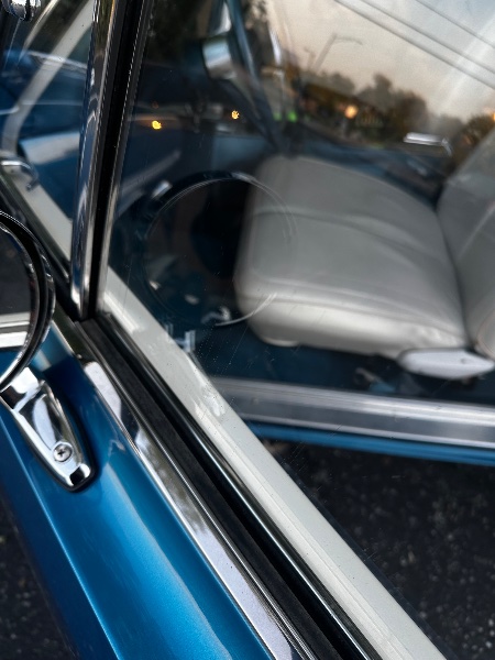

Also the drivers side window needs adjusted, it is SUPER tight to roll up and down and has little scratches in the glass, it was super hard to get in the picture but there are scratches. Most are by where the reflection of the mirror is in the glass.
