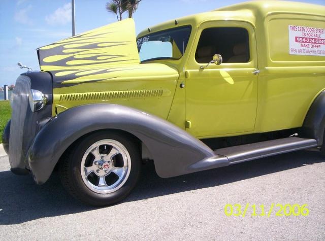

Single stage. No need for bc/cc unless you are going metallic. The '69 Coronet R/T I painted a few weeks ago was done in single stage. Even then, you can still use single stage - I shot the fenders, grille shell and flames on my '36 with Nason factory pack single stage
