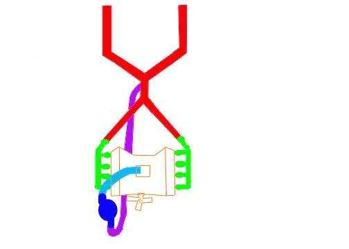

So just to make sure I have it right this is what I think I have to do...
The diagram you provided will work. In reality, the down pipe will probably come down on the passenger side, and any number of vendors make a good Y pip, that will allow you to smooth and with minimal flow interruption, divert 1/2 of the exhaust over to the driver side.
So i would use the Y to connect down pipe to both sides or to connect only on passenger side?

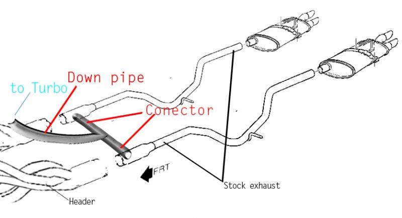

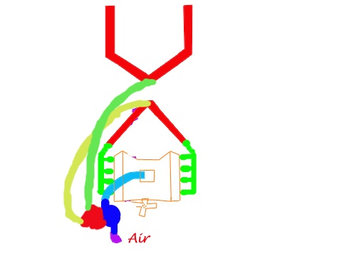

I'm still not sure how to close the loop, did you mean bring it back to the drivers side or just another y at the turbo or something like this?

don't mind my inferior diagram lol.... but i was thinking something like this
I would run the down pipe into a single tubing then split it off into duals

I cant just tap the exhaust system as in Dusters and my incredible diagrams? the system has to be fed through the Turbine only and it must be equal. Correct?
The exhaust will need to leave the engine through the heders/manifolds into a single pipe that will go to the turbine inlet through the turbo and out a single pipe and then split in two and reconnect to your existing system. Just like the old picture you posted. I would use the shorty headers like Maddart used and then use a T04 turbo and give it 10-15 pounds of boost and meth injection to intercool and raise octane levels. This combo on a 318 would yield low 11s in an abody. I actually had this very set up on a car before and it was killer.
What you have pictured will work great.

Prine's diagram is spot on, the only difference is the down pipe after the turbo would go under the car, and using the Y pipe I pictured above, would split from the one single down pipe into 2 pipes, to join the existing dual exhaust.
The picture you posted in post #10 is exactly what I have in mind. Where the exhaust crosses over to join the drivers side is up to you, but you are on track.
