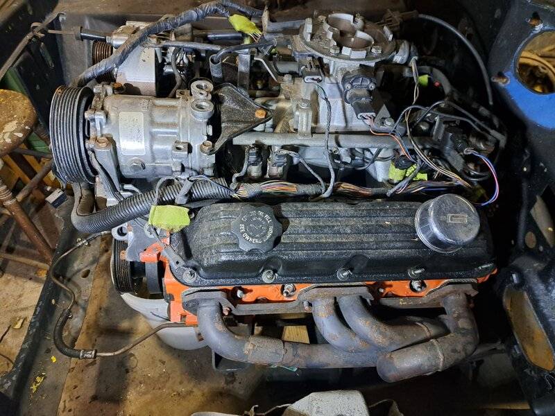

That is a Magnum motor peeking out of there, but it's not the 1992 B250 van engine I was originally planning on using. It's from a '94 Dakota and has a Comp Cam with .484 of lift, a Hughes dual plane intake that could be ran carbed or fuel injected, and a set of shorty headers. I pretty much cannibalized the entire truck for its drive train and wiring harness.

More pictures of the Dakota engine. It cleaned up decent.

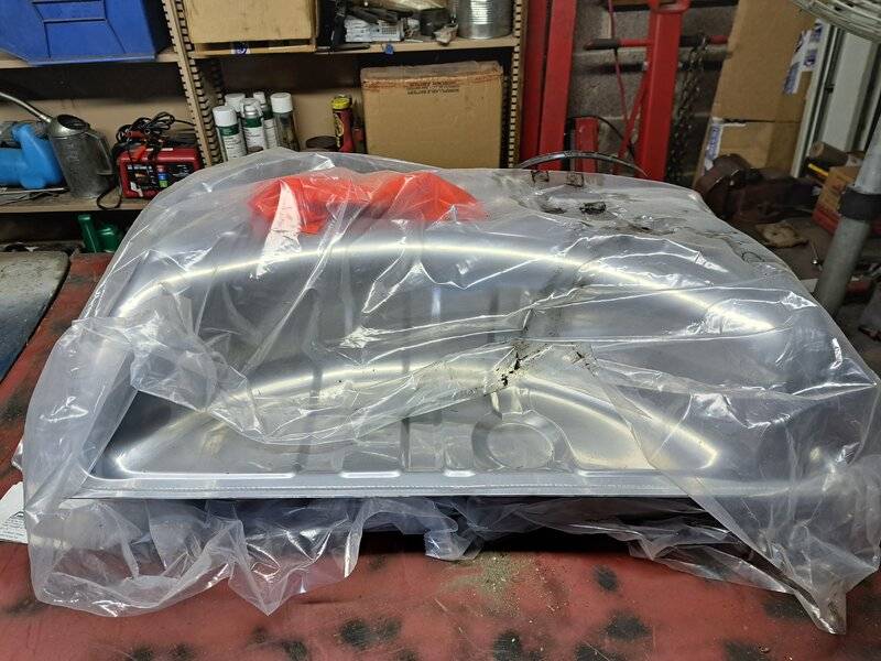

Classic Car Performance makes a full retro fitted tank for running EFI. It has a sump area for the high pressure pump and is recessed on the top for the pump and sending unit so no cutting of the truck is required. And it comes enough fuel line for the supply and return, fittings, pump and pressure regulator, and a new sending unit.

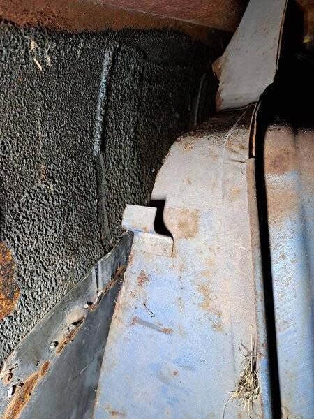

After buying everything with plans to build a car out of, I found some questionable work was done to the shell that bought to replace the original Dart with.
I could deal with the filler neck filled in and the wheel openings being replaced. It was the fact they cut out the inner fenders, leaving the structure of the C pillar to hang out without much support.

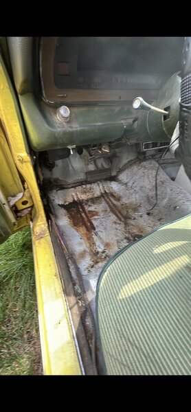

Turned out to be a pretty solid car that wasn't made of Bondo.
I haven't seen floors this solid since I left the South. Yellow is obviously not the original color, but I can live with it.

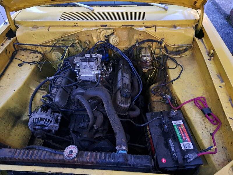

It has a 318 with the standard "go fast" parts and a 904. It idled like it had a rowdy cam, but it wouldn't rev up. More on that later.

Finally made some progress pulling the 318 that was in my car.
No matter how careful I am, I manage to make a mess.
She's in there like swim wear.
I know the electric fuel pump needs to be close to the gas tank. This is set up to test run it.
