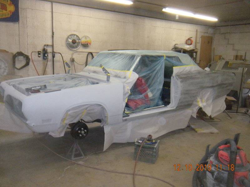

My car is in resotration since August 2019. it has been sitting and not started. I recently went to start it and the welder guy blew out my Pertronix. It would crank but no starter. I think I strained the starter trying to figure out what was wrong and why it would not start. Before the no start issue the factory starter worked great. I think I hurt the little guy. I did recently buy a mini starter. I hate to chuck out the factory starter if it only needs minor work. When the factory starter disengages it's more like a slight sanding sound.
Starter "drive shaft" runs on two bushings-no bearings. Is unlikely that bushings are bad, but possible. Remove the starter to inspect. Is more likely that the leather washer behind the driven gear is bad. We can help you if you have pics.
Murray. Starter is still on car. Getting ready to move the car to the paint booth.
