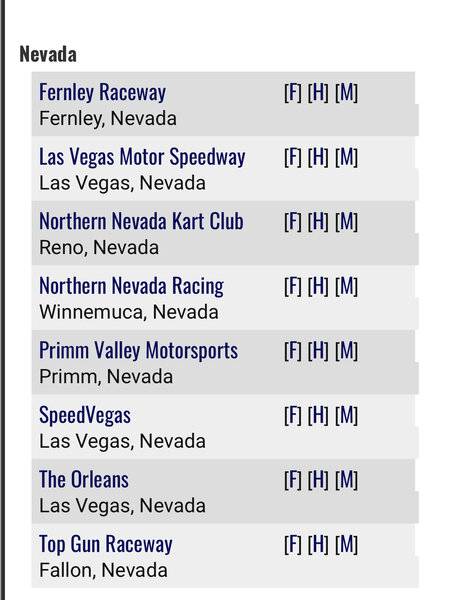

state is Nevada. I would guess he races at Winnemuca. Jack said he races at 6000 feet altitude.
not sure how much he races either, but this is his second year on the motor, so it’s certainly not just a show poodle.
6.40’s at 6000 feet altitude is not slouchy at all. He was recently in a final against a B1 headed dragster, so I would guess he races box
