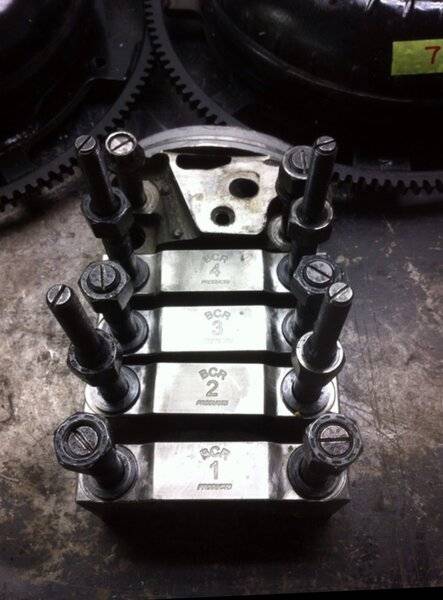

From the “unobtanium“ archive…… the bottom end on our W5 / 340 block.

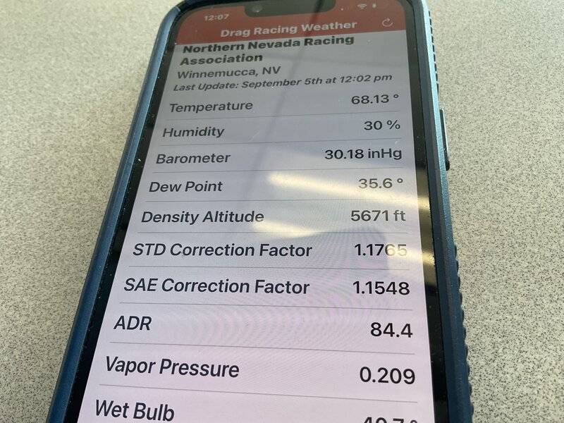

Took a look at that track outside Winnemuca, Nevada out of curiosity to see what track conditions are.
Bearing in mind it’s currently 68 degrees there with low humidity and 9 in the morning, so I would guess pretty stellar conditions for that place…
