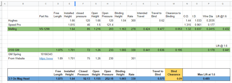

I plugged in some of the valve spring info I found online for the GM 3100 spring, thanks to Patrick at the Moparts forum.(new cheap magnum spring upgrade for moderate cams) I used a bind clearance of 0.09" which gave me a max lift of 0.485 with a 1.6 ratio rocker.

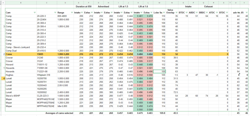

Below is the cam info I worked out, the whiplash cam from hughes caught my eye but I had to work backwards from the specs they give and do some guessing to compare it to the other cams. The lift was too large.
I went way further into this than I should have but I wanted to make the info available if anyone ever wished to use it. Nothing has been purchased since I'm still confined to my house... hopefully be able to make it to the salvage yard soon. Also, debating to just use some 302 smog heads, better springs and a bigger cam. I liked the larger valve and smaller combustion chamber the magnum heads have... as well as the 1.6 ratio rockers.

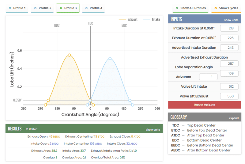

Used this graph to compare the cam's once I picked a few that worked, it was pretty interesting to visually see the lobe separation, duration and when the valves open and close for the different grinds.
Camshaft Calculator & Valve Overlap Profiles | MGI SpeedWare

anyway to make that spreadsheet live?
The Hughes is quite a bit fatter lobe than most of the rest but i have no idea what it is at .006 if anyone has measured it post up- use only on stock low compression builds

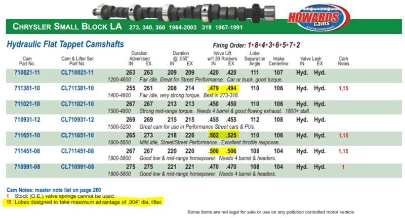

The first Howard 710011-12 is a Street Farce 1 transplanted chevy cam
Howards 712221-08 is another optimized for the small .842 lifter and quite a bit different than the Street Force- You are not considering both of these for the same build are you?
The Lunati Voodoo -700 has good lift for that duration as does the 701 Looks like the only MOPAR optimized cams on your list
For Crane- Crane measures advertised duration differently than the rest of your list (?Hughes) so subtract 7 degrees from Crane's advertised when comparing
All the comp cams you listed have marketing names but until you get to 275 degrees comp is not competitive
Anyway to make that spreadsheet live?
I'm working on it now, trying to figure out a way to share it easily.
That's what the website states, I had to work backwards on these numbers so the Hughes is a rough guess.
I threw a bunch of random cam's in the power range from Summit I was looking for. Some have too much lift for my combo, some I didn't like at all but I went through the work of adding them so I left them.
What do you mean optimized for Mopar, the larger lifter diameter I assume? I would like to take advantage of this but I don't necessarily understand how. The larger lifters allow for a more drastic ramp right? So a faster opening and closing to the valve? I do like the Lunati but it went over my max lift, the 700 is still on the table though.
I wasn't aware of this, where can I find his info? That would make sense because the graph online looked off on those cams, the curve was much steeper leading to the @ 0.05" lift number.
What do you mean? 275 degrees of advertised duration? The long duration comp cams seemed like they all had too much lift for what I was going for.
If you have cams I should add let me know, no real science to how I put them on the list. Should probably remove the cams with too much lift.

I got the link to work and added some more cams. This time I threw in some Mopar cams that would work and I think I understand what Wymer was referencing. The mopar cams have a ton more duration than the other cams so I assume the lobe may be a bit "flatter" possibly?
Here's the link to the spreadsheet if anyone wants to play around with it. Definitely not claiming any of this info is 100% accurate, I make typos easy. Hopefully the link works for everyone.
Wyrmrider, I laid some mopar cam's into the graph and the difference was pretty drastic. Thanks for the schooling!
The graph for the Crane 15005 is below, the ramp from advertised to 0.050 is really shallow... fit for a small diameter lifter.
The Mopar purple shaft MOPP4452761AE is below, the points for the duration at 0.05 & advertised are much closer together.
And the Hughes really shows off the drastic change with a higher lift, I got the advertised duration from using the averages from the Mopar cams vs. the average with for the ordinary small lifter grinds.
I'm a visual learner so the graphs helped me wrap my head around it... more area under the graph the more air in and out!.

I think you may be off on yur hughes adv durations go to the howard catalog and find a 213 & whatever the ex lobe is @.050 and use those oo6 durations

on your crane graphs remember to subtract 7 degrees
crane's advertised is at .oo4 wheras the others are at .oo6
I used to use 8 degrees but found on the Camcraft website a listing with both .004 &.006
btw camcraft learned from Harvey Crane not UDHarold
now for MP
MP uses a unique way of measureing duration
but it works out to close to .008 (also Engle and Racer Brown))
so for the MP cams I'd add 8 degrees to the advertised
These additions and subtractions are necessary for dynamic compression calcs too

I did subtract 7 numbers from the crane unit but I didn't look at the lift numbers, I'll have to do some more digging, I thought the specs in their catalog were based on 0.05" but I'll double-check. Thanks for the info on the trans, I was going to start looking into that tonight!
Wyrmrider
I've come to realize that I can't actually map the lobes out with the advertised, and 0.05" numbers since everyone's advertised is completely different. But I was curious if I could at least compare all the Comps since they should be apples to apples. If so the Comp 20-300-4 seems like it has a tight advertised to 0.05" duration delta but I can't tell what it does from there. I did look up the grind number and it came up with a bunch of Chevy stuff so there probably isn't any hope for that unit. I did look through Comps lobe catalog and their Chrysler cams that are optimized for the larger lifter all have too much lift for my application.
I know you mentioned Howards cams and Vodoo, the Vodoo part number 10200700, But I'd like to go with a cam with a tighter lobe centerline, at least a 110. I found the Howard "Aggressive" lobe profiles but I don't have any way of knowing what cam's have those profiles. Let me know if you have a way of telling without just getting the actual cam in hand.
I am going to Comp and Howard's tomorrow and see if they can give me more info. The catalogues have a lot better info than you can find on the product descriptions... too bad they don't have the lobe profiles tied back to the cams somehow or maybe I'm just missing it.
I told you how to do it
most everyone is .006 except Crane, Cam Dynamics, Summit and the white Boxes at .004 and at these durations scratch all off your list
Then the MP, Engle and Racer Brown at .008 and Isky just add 8 degrees you will be close
As for comp there is absolutely nothing shorter than ,275 that you should be interested in. The Purple Plus 280 is the smallest in that line and the Nostalga Plus is a similar design but dumbed down to make mfg less expensive- you loose torque compared to other cams with similar advertised durations on the list I posted
you can get the details in the comp lobe catalog which btw is much better than most

you could squeeze your spring down to .060 or change keepers/ retainers if that works mechanically clerance
would give you a lot more chices
as of right now the jones motorhome grind may be your best choice
check the lift
a lot of amc 1,6 rocker guys have written on this cam- me too even at 1.75
no problem
You should be able to make the Lunati 700 work Ive seen two versions one is 250-206 intake and the other is 253-208 intake
as far as I know (AFIK) it's the only shelf cam that comes close
you could have Lunati grind with the 700 intake and the 701 intake ground on the exhaust giving you 253-256 @.006
You could have Engle grind the K-52 (good lobe) on the intake and a slightly longer (depending on you head flow and exhaust) exhaust from their cam library to meet ex lift
This is the best combo that comes oh so close
Jones 256 202 120 .305 .461 50% fatter @.275 than DC 260 (269 @.006) .305 lobe is only .002 above your spec
H64307-66299 256/264@.006 202/208 .307/299 .491/478 w/1.6 111 LCA IC 109 ex 114 you could have the LCA wherever so find another .007-010
you could also have Mike spec a different ex lobe to match your ex flow reuirements- actually it's better to let him pick the lobe once you nail down your needs
Crane also has some out of catalog lobes
Crane 2022880 252-4 202 113 0.299 H2 series .904 lifter (260@.004) The 252-4 is my .006 estimate
but you can see that the Jones is considerably bigger at .200
The Engle and Jones are sort of Dwell cams big noses for great wear
