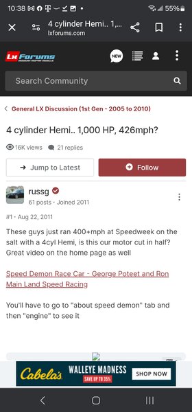

A 4 cylinder based on half a big block would be interesting, don't know how/why it's a 318 replacement.
Problem with 4/6 cylinders less intake/exhaust ports, less overall flow. But a TF/B1 headed 4 cylinder be kool :)
Talking about 4 cylinder mopar
