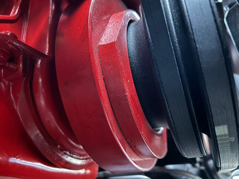

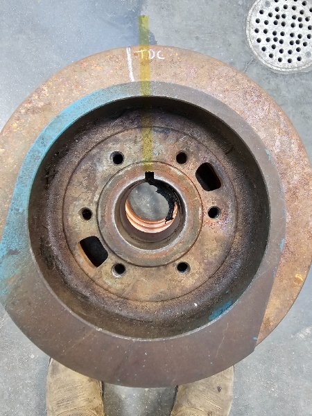

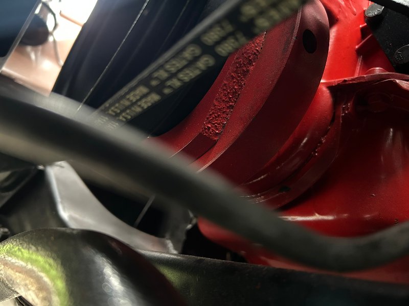

Yeah. That's certainly an idea. Maybe someone could post up a GOOD picture showing where that outer weight is, in relation to the TDC mark on the balancer. That would tell you real quick.

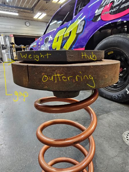

The offset weight is one piece with the hub that is keyed to the crankshaft so even if the outer ring was indexed wrong or slipped the balance would still be right. However the tdc mark could be incorrect. This is a picture of a stock balancer. It appears to be in good shape but no guarantee it is correct.

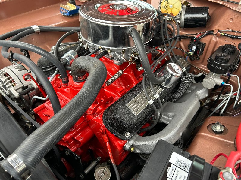

To update the followers, my engine shaking ended up being my timing was way too advanced. This is a new build, so I have a ton of variables... anyway, I had no pinging or sound of the starter grabbing, but yeah..... too advanced. Now.... I still have a drivetrain vibration, but that's another thread.

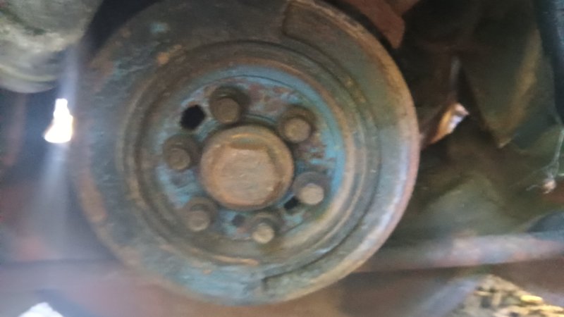

Sorry for my post.....the LRE 360 does have the external balance balancer - just a different type.....just didn't notice it in all the fury...
