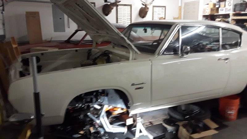

For 5 years in a row, every fall I would take put my 367 and install my winter 318, and every spring I would re-install the 367 after having gone thru it. And usually, I would install a different trans at the same time, and swap the rear chunk as well.That 68 Barracuda was my DD. So I always picked a long weekend and started Saturday morning. And was usually motoring around on saturday night. This on a drive-on hoist with a cheery picker. One time from underneath but that actually took longer.I think the longest I ever took was 14 hours for a complete powertrain swap. But wasn't always all in a row. (yes power-steering/power brakes.)
The very first time was a bit of a pain cuz I couldn't remember which side of the lugs the brackets went on and I had to notch the K for pan clearance. I had prefit the headers outside the bay and discovered the 90* adapter didn't need to be there with the TTIs. I had made an engine tilter, but it was a little on the long side so it wanted to hit the firewall before the engine/trans levelled out. I had made the pick-up point adjustable so I just had to drop everything onto the K and move the balance point. Of course the headers were already positioned, so they had to come out first. Yada yada yada.
I feel your pain. I have the biscuit mounts so that at least was easy. And yes I guessed right as to the lug positioning. Yes the steering had to be dropped, and on the first go-round I pushed the T-bars back too. And I wasn't all that careful about the paint either. I knew I was gonna be taking those engines out multiple times, and chit happens.
But you know what, in year 1999, at the first install........ I was only 47.
By the 11th and final swap, all the bolts knew their way home.
After that I was no longer finding issues in the engine during the winter freshening, and I was finally making a little money; and so I bought a winter beater.

I just pulled the slant and installed a 440 awhile ago by dropping the whole k frame out the bottom its stupid easy. I will never pull an engine out the top again just not worth it.

Installing the entire assembly (motor,trany,kmember,steering,headers) from underneath seams like the hard way but you can line everything up before install and save a lot of frustration.
