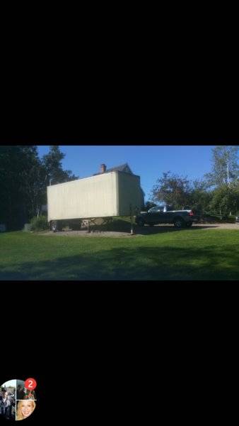

Yeah, Sold the house but Packed up all of Garage and bought a 28' Trailer to store all my car stuff. Plan to move south in 2 years.

another trailer like that and you could have a portable workshop- I liked the way you made your old one look
