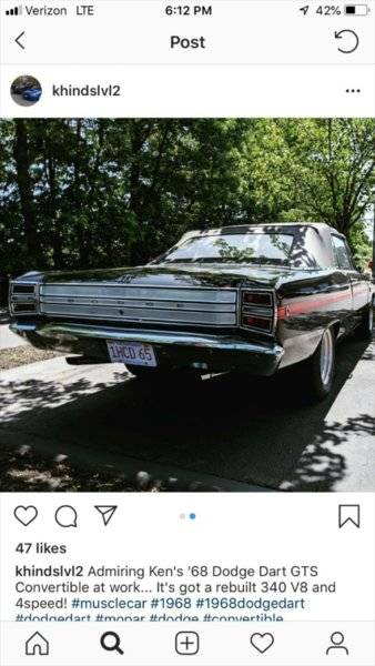

I agree . I'm scrambling right now as I sold my house and have 2 weeks to get out. When things settle down I will start a thread. No garage for a long while.Really gonna miss it. Couple of pics of car my friend took on Instagram.
