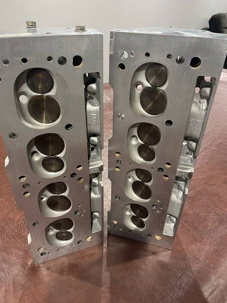

Regards the OP’s car, the other thing is, are the heads really as good as people think they are. That would be the thing to me.
I think when the other guy had it, weighed a little over 3200, and it went around 130 mph, or close to it, if memory serves. So I wouldn’t guess anything is off that much. To me, it would be more how good the heads really are as my first place to look. They have been redone, but I have yet to see those heads put up what I would call impressive track numbers they way they come.
