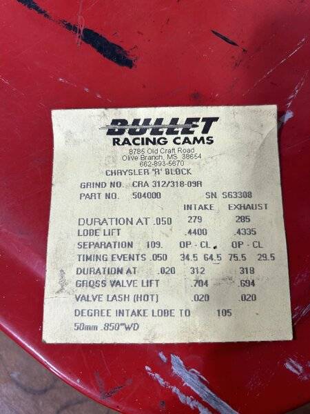

I checked PTV clearance at TDC, +/- 10 and 20 degrees. I am working with bullet. I don’t want to go larger than my current lift which is 660. Duration I think something around 268/274 with a 108 LSA should be close.
I do agree that you do need more duration.
The bullet cam would be the one I would pick out of the ones you listed.
This is the cam that’s in my 414”.
Would love to know compression, stall and shift RPM’s as I have a very similar grind from Comp that I’ll be running in a Victor headed 420”, 2800 lb duster (if/when I get my car back from bodyshop jail :()
