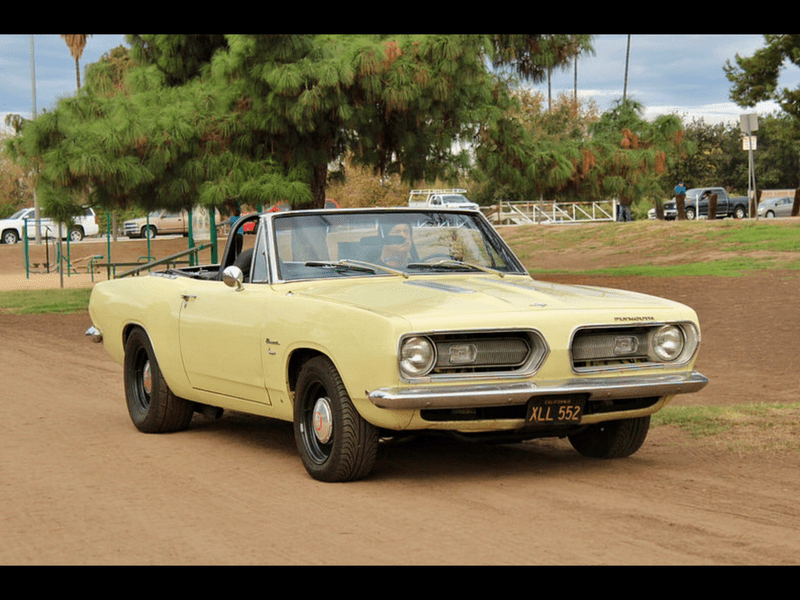

I'm running that size rim with a 275/60-15 tire on my '68 Barracuda. No rubbing even on the roughest roads or hardest launches. I used two passenger side 3200lbs SS springs, sway bar, properly adjusted slapper bars and Koni shocks.
When it becomes time to replace those Koni's I'll buy the QA-1 single adjustable shocks like I did on the front. Great shock for the money and the adjustment range is spot on.

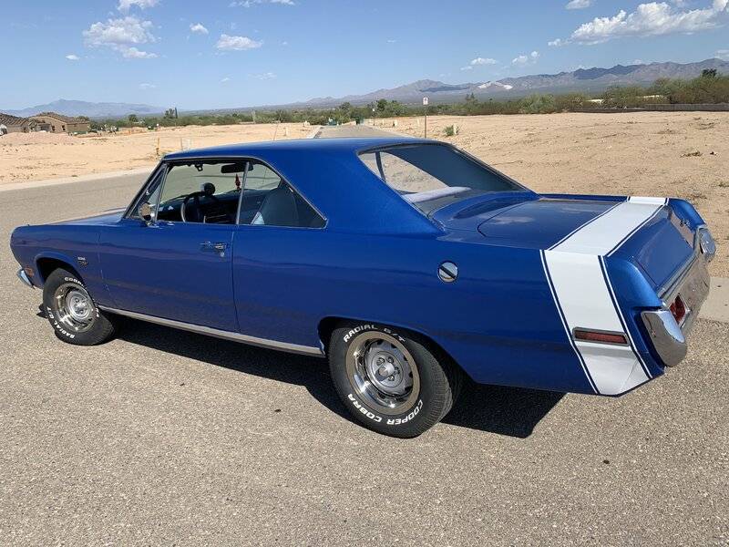

here are pics of our 70 dart.
15x7
4.5 backspace.
large bolt pattern axles and c-body drums
225/60-15 tire.
Very cool looking car!

I've always loved the stance your car has. That picture of your car is the one I found a few years ago when I was searching images to find the right tire/wheel combo for my Scamp.
