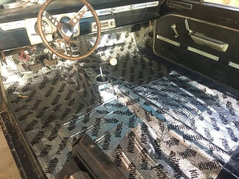

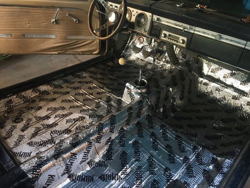

I bought 50 sq ft of 50mil Kilmat through Amazon. $87 shipped. 2 hours this afternoon, and I still have enough left to cover under & behind the back seat. I thought it would be thicker, but install was a breeze.
Other locations to use Kilmer are the inside of the door skins, quart panels behind the quarter windows, and roof skin before a new headliner.
