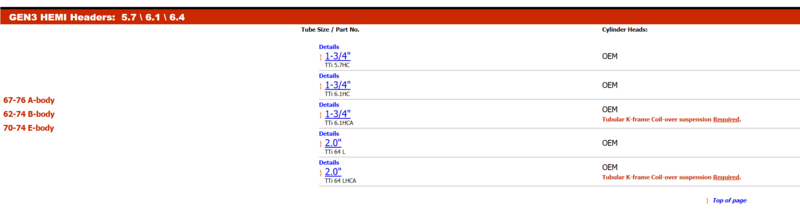

Are you sure your TTI's are for the small port 5.7 heads only? Could be they sold different sets before, but as of right now what TTI sells is for all G3's (5.7, 6.1, 6.4, 6.2). I would bet your set fit both the 5.7 and 6.1 as at the time that's about all the G3's being sold, and the 6.1 uses the same exhaust port as the 6.4 and 6.2 and the Eagle 5.7. If your set fit both the 5.7 and 6.1, they will fit an Eagle 5.7.
But it is true that the '08 and older 5.7 had a smaller exhaust port than the 6.1 and later motors.

Digging through the literal "Wayback Machine" (the Internet Archive is wonderful: Complete list of TTi Headers, it looks like the 5.7 and 6.1 were different:
Granted, I'm not 100% sure how different they may be. I suppose it might be easy enough to tell from just looking at my flanges and where the tubes meet as I would expect the upper end to be curved to match the D port design, but I've not seen any other TTIs in person to know if they actually used matching flanges or a more generic style and just oversize.
I'd almost be more tempted to run a truck style intake, though I'd have to look at the new ones to see how they work. The old 5.7 truck setup had a top center inlet that might make better use of my hood scoop than the car style front inlet, plus it would let me keep my truck front cover and accessories. Though I guess I'd probably have to get an Eagle timing cover as I'm guessing that would be different for the VVT stuff. I might have to start up a spreadsheet to track the options and costs. I did my swap nearly 15 years ago now when there was a lot less options to work with. I haven't really kept up with all the differences in intakes, accessories, etc. on the newer stuff. Tuning VVT would be another learning curve, but assuming I can't do anything too stupid that would let me run a valve into a piston it would be fun to have another knob to tweak and learn about. My dad's Scat Pack Challenger is a hoot to drive for all the bigger it is than my car, though I worry that would be way too much power for the condition of my chassis.
Sure enough, looks like they had a different set.
Appears the 5.7 headers used a round tube:
The 6.1 headers used a D port:
The early truck manifold would fit your current motor but not an Eagle. And the later 5.7 truck intake has the TB pointed straight up and would be hard to fit and the SRV module hits the firewall like the 6.4 car intake.
