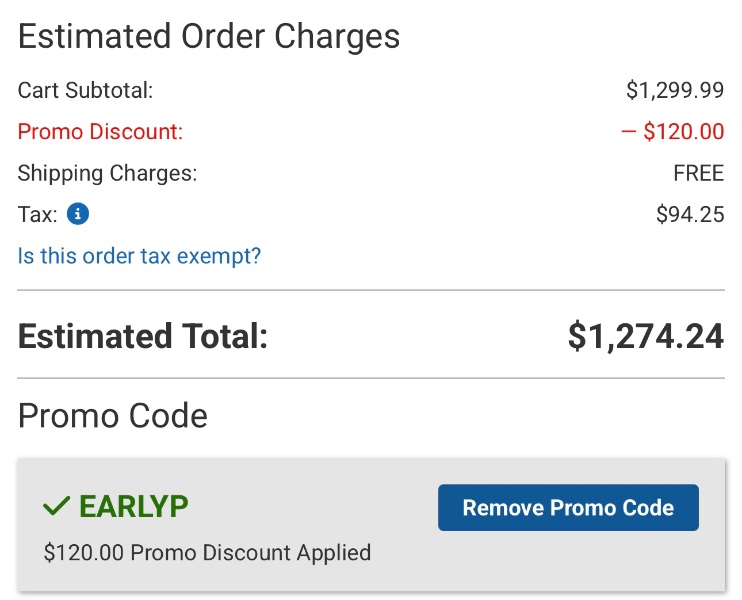

Just so everyone is on the same page…….the TF heads are priced “each”, the SM heads are priced per “pair”.
In other words, the TF’s are over 2x the cost.
