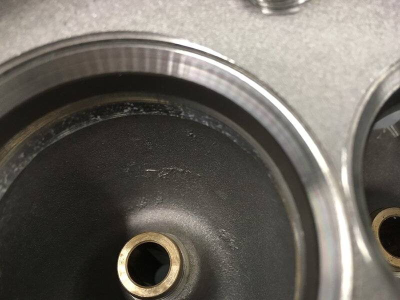

The Promaxx heads are very nice, and the finish work is superior to the SM
Largest gripe I have about the SM heads is the hard, hard seat material. Seats are a pleasure to cut on the ProMaxx and the TF compared to the Speedmaster.
Interesting……
Granted, I haven’t worked over a set of SBM SM heads in a few years……. And who knows if what I worked on then and what they sell nowadays even come from the same source………. But I didn’t have any trouble with the seats on any SM heads I’ve done.
I’m guessing they are a powdered metal. One or two seats will dull a new carbide cutter. Nicks/lines start showing up quickly. Chatter potential is much worse as well.
The SB SM heads I’ve had here def didn’t seem like they had powdered metal seats, but it wouldn’t surprise me if they did these days.
Lots of heads use them now.
I got a lot of practice with them prepping Indy EZ heads.
I’ve never been able to get a satisfactory finish on them by machining alone. They get finalized with a stone.
