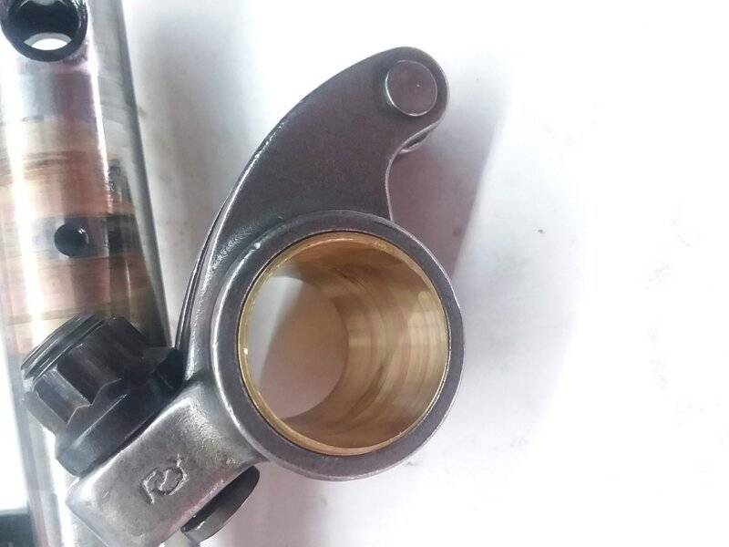

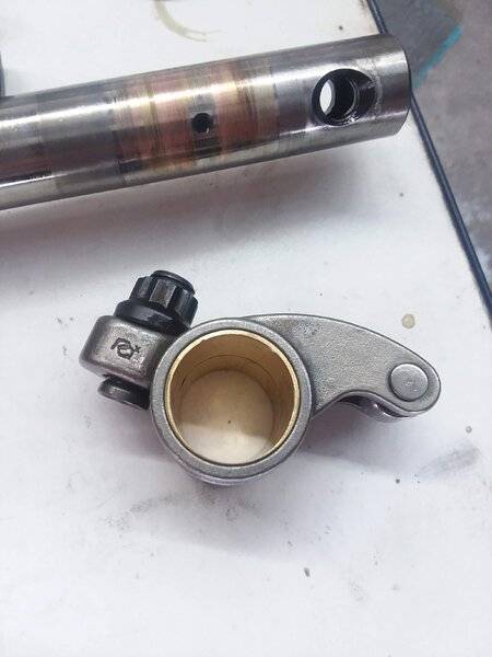

Miles I started hearing more and more valve train noise.
So I took off the rockers and found all the bushings were wearing out.
Leaving metal transfer on the shafts.
I called Mike and he had me send them back to him to inspect.
He was so nice to warranty them for me.
He also suggested that I should add pushrod oiling.
He also suggested that I call PRW as well to let them know what happened.
They also suggested adding pushrod oiling.
So I changed all the lifters out to AMC style.
All went well for almost 1 year, but recently the valve train was getting loud again.
Pulled off the rockers and found number 8 exhaust Rocker arm bushing almost worn clear through.
Another one on drivers side was worn too.
Most of the others seem ok as far as the bushings go.
But now I found some of the roller tips getting flat spots and feel rough to spin with your finger.

In the pics you have posted, it seems to me the rocker arm shaft oil holes are
more in line with the hold down bolt holes? Are the rocker shafts OEM or aftermarket?
Just check your shafts to make sure the oiling holes are facing to the lower side, to
the bottom edge of your valve cover, or to the exhaust manifolds or headers. If the shafts are OEM units, have you ever knocked out the end caps, and clean or have the shafts
boiled out at your machine shop? Just some FYI.

The Rocker shafts are PRW that came with the kit.
The first set had oil holes on the bottom inline with hold down bolts.
The second set are drilled straight through with oil holes top and bottom.
Probably to make them fool proof.
Or maybe to help with oiling.

Oil hole in the top is of no value, you want to get the oil to the rockers main friction point, which is obviously the bottom. Widest clearance between the rocker and the shaft will be at the top. If the oil can escape there first, then it will.
You then want to spread oil across the bush, that's where a small oil groove comes in. Then you need to make sure it's getting enough oil.
I also agree with Bakerlite.....as the bushing would benefit tremendously if it was
cut with a groove! Does the OP know if the main rocker shaft is made of some type
of stainless steel? I am now wondering what the Chinescans were/or are using for
the inner rocker bushing? There are many types of bronze out there..... and for
what it is worth, are they using 100% oillite bronze for the production of these
rocker bushings? IMHO, by me viewing the rocker shafts (I am 60yo in two mos) eyes
are getting worn out) but the pics do show some different heat coloring on many areas
of them, which makes me think, these bushings are not made out of 100% bronze?
Maybe, some kind of other ionized powdered metal, or some other, ferrous metal mixed in. IDK?? Something is going on! I will run this situation by my 6 different machinist friends, and see what they all have to say. I will check thread tomorrow, as I do not want a headache before bed tonight.

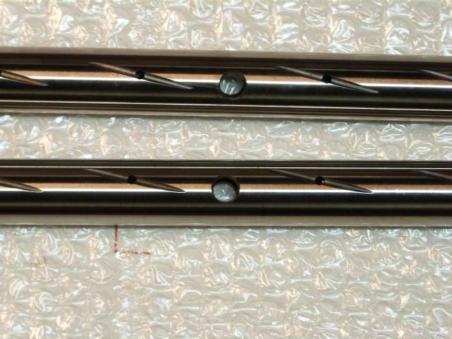

Check these shafts out. Note the orientation of the oiling holes vs the bolt holes and the oiling grooves. These are nice pieces. [FOR SALE] - Small Block Rocker Arm Shafts for Adjustable Rockers - New
Thank you

Then the only thing left is the lack of nanner grooves. Am I seeing that right that all of the wear is on the bottom of the shafts and the bottom of the bushings? The lack of those grooves is keeping a good oil cushion from happening, imo.
I would also include maybe a bad batch of the bronze bushings, but it would have had to happen twice now wouldn't it?
I think that banana grooves would help.
I did put on a set of 273 rockers with banana grooves now so I can still drive it.
I also did that after the first time and after taking them off they show no wear at all.
