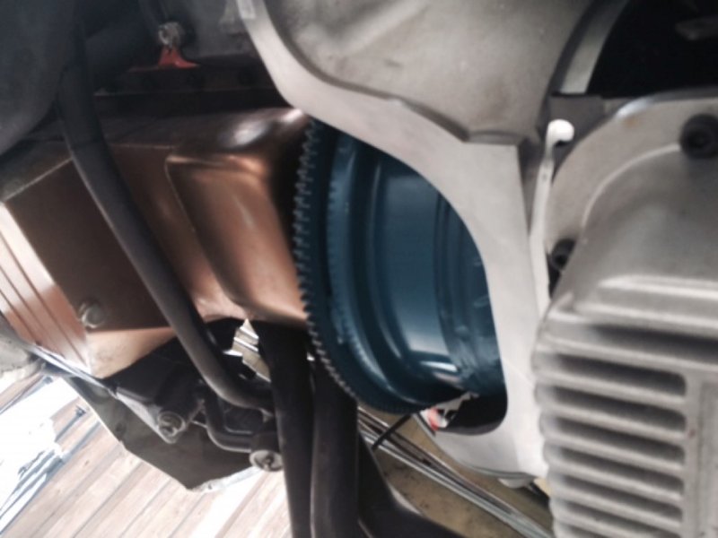

I run a 3 plate, carbon fiber lock-up converter in my ride. I read on these forums to spend the money for a higher end converter, which I sourced at Precision of New Hampton. It stalls at 3800 rpm, and locking and unlocking the converter in 4th gear on the highway at a steady state cruising speed only changes engine speed by 350 rpm.
It feels like a normal converter at low throttle settings and is otherwise hard to tell it has a medium stall built into it. At high and full throttle settings, it allows the engine to get into the power band instantly. One of the best places to spend the bucks in my experience.
