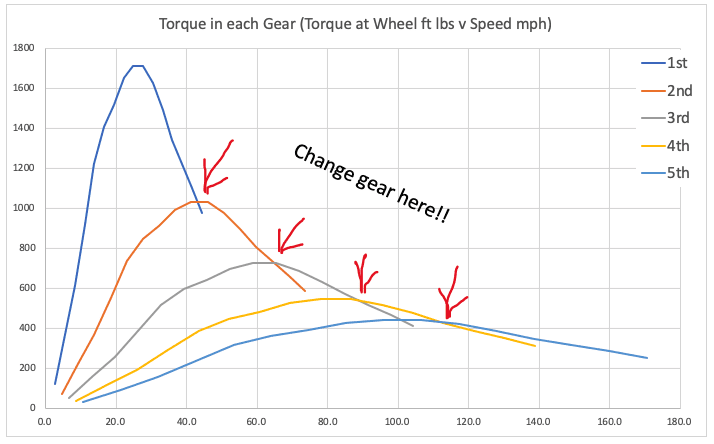

You can also do this with one of the in car performance monitors. What you want to do is generate curves where they intersect for the gear changes for "anything"---torque, HP, acceleration. You shift where the curve for 1st gear intersects the upcoming curve for 2nd gear.
If you cannot generate a curve for every gear, then generate what you can and "figure" the rest from the transmission ratios

Exactly the type of thing I was referring to. But this is not quite right. You need the intersect point of the two gears.
"If you can" you want the curve in RPM, not MPH as the example curve I posted. But you can "diddle" it once again, with gear ratios to figure RPM vs MPH.
