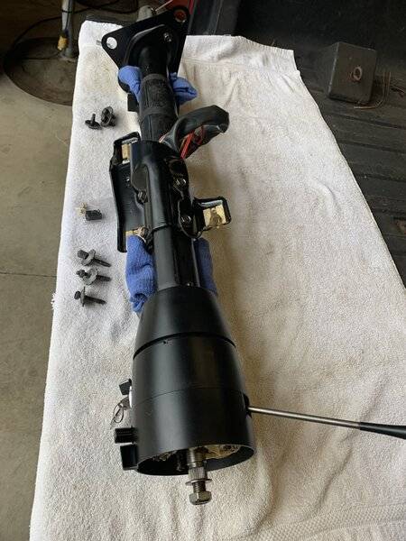

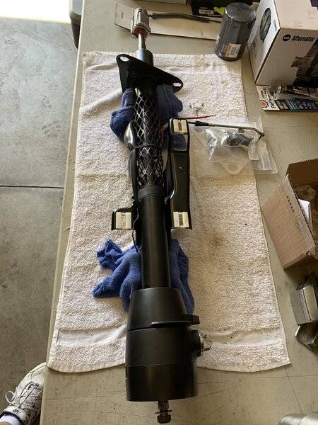

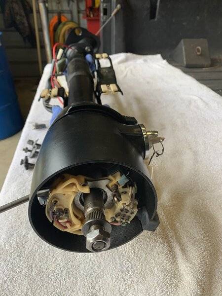

Yes that pin comes out. I remove mine just as you described it. But I have a very large vise. It’s in there tight. Just rebuilt this 72 Duster column.
