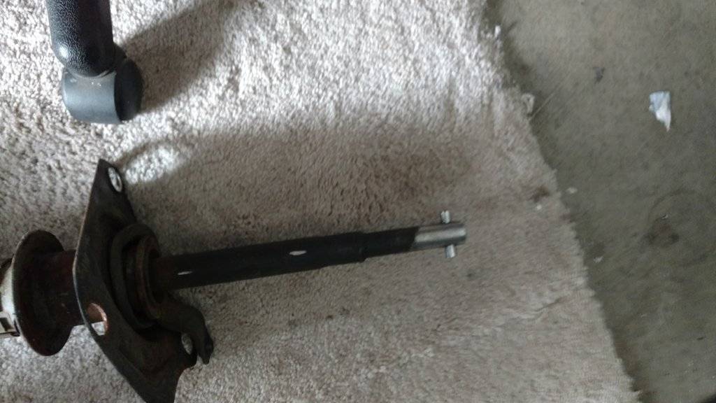

1) Locate the roll pin at the end of the steering coupler (at the far end of the square thing at the bottom of your photo. Turn the wheel till visible and drive it out with a punch.

You can see the roll pin in this photo...

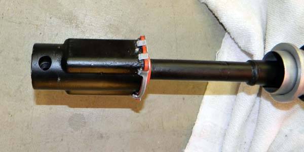

Ok, what am I missing here??? There's a 3 1/2" wide metal wheel that's notched. It won't come out, and on the bottom of the shaft there is the T. So either way I can't slide the shaft out. Any thoughts, besides the obvious that's what he said jokes?

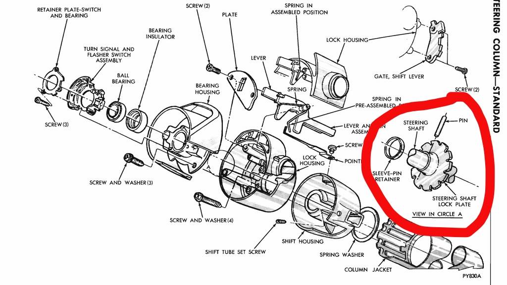

That pin at the bottom is absolute hell getting out. I didn't have the notched wheel in my column but I was able to find a diagram. One sec please.
I think it's the drift pin that was discussed up above. Read over it carefully. I need to do mine also. Guys are telling me the pin can slide out once assembled. One guy told me he made a clamp to hold the pin in......If the pin comes out you loose your steering capability.

I haven't been able to find a '74 FSM free online, but that looks like a cover to me. I'd bet if you could bend those tabs out it would slide off and reveal its mystery lol.
There's a How-to on here to put a sealed bearing in the bottom of the column, replacing the nylon one. If you wanted to do that now, it would be a good time as you've got it all apart and can put the shaft in a press to get the cross pin at the bottom out.
