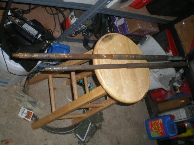

Manual 40 3/8"
Power 36 3/8"
MS shaft came out of 67 Barracuda notch
PS shaft came out of a 68 barracuda notch
cant find pic on my camera have to go out and take another one
