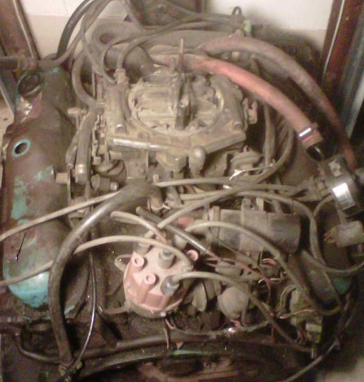

Can you post a picture of the TQ?
For the most part, you can plug up all but one, the bowl vent on the side @ 3/8 hose size, should remain open.
Does this carb have a port for vacuum advance? If not, it is the wrong carb to use. However, if your Ok with drilling a hole for a vacuum tube for a vacuum advance....... Just copy an earlier version.

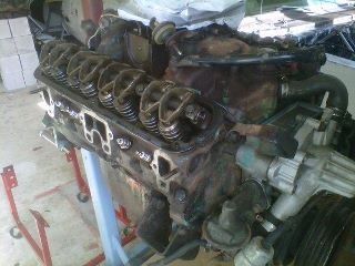

Here is the motor just after being pulled.
It was suggested in another post by members that if I don't have the funds to tear the whole motor down now, I should just run it as it is.
So the plan is to degrease and scrub it, do the oil pick-up and passenger oil pan, remove all smog components, plug the EGR ports on the heads and run it with a new small Holley or Eddy carb on the stock iron intake.
Everyone in the world says to ditch the 1984 era smogger ThermoQuad.
As you can see in the pics taken just after it was pulled from the truck there is a bout 50 miles of smog and air rubber tube on that motor.
The question is how do you run a stock 1984 360 with a stock intake with a non smog Holley or Eddy carb, and remove all the smog stuff?
If your not going to tear into the engine, leave all the smog stuff on and hooked up. The engine will run better that way since it was designed to run that way. De-smogging the engine and leaving the smog carb on top will result in a poor running engine.
There is nothing wrong with the TQ? Then leave it.
