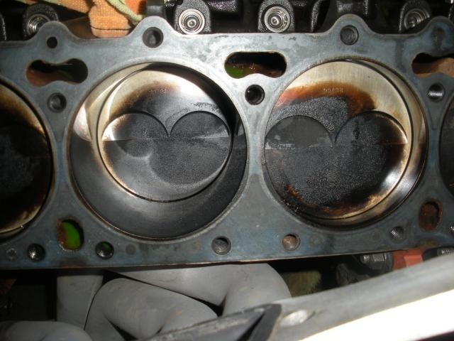

I was under the belief that I was running at 10.73 to one. After cleaning the pistons and REchecking deck clearance, I found that I was .012 in the hole instead of .017. Then I started thinking of how I've had these heads off the engine a few times and had them lightly surfaced each time. The resurfacing surely reduced the chamber size by a measureable amount. This means that my actual compression ratio couls be closer to 11.0 to 1 but I still am at .051 quench distance at best. The 191 average cranking PSI shows that I am over the limits of what I can run with 91 octane fuel.
I asked around about what actual physical signs are visible if detonation is occuring. Some told me that the tops of the pistons will look like they have been hit with an icepick. I looked at mine before cleaning the carbon off and found absolutely no markings like that. After cleaning, the result is the same.

The mark below the exhaust valve notch in piston #1 is from where the flimsy piston stop made contact.

I'm no engine expert, but I solve other mechanical problems for work and otherwise. You gotta measure everything and nail it down, write it down. There's lots of guys here that can help, but without good hard data, they are in the dark. A picture is worth a thousand words, but doesn't give dimensions.
I recommend starting a Word document on your computer that you can copy and paste good info into, as well as keep your own notes.
My gut says get some quench and look to the cam to reduce cylinder pressure...but my gut doesn't count for much.
