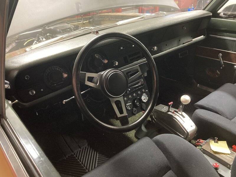

The OE steering wheel on this 68 Barracuda is just absolutely perfect. Has a nice shine, no cracks.
I am wanting to drive the car aggressively and I felt that a thicker steering wheel rim would give better turning grip and at the same time I would not be stressing the nice OE steering wheel. I like the way the Tuff Wheel looks and feels.

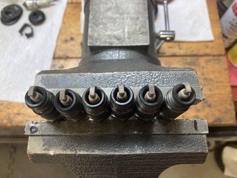

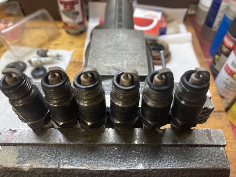

Pulled the sparkplugs to do a compression test
the cranking pressure for 1 to 6 are
195, 190, 183, 190, 183, 185
I also adjusted the valves
I have the AF and VE tables adjusted good enough that the car starts and drives easily. No bogs or hesitations.
I think I can tune it a bit better for more performance and economy.

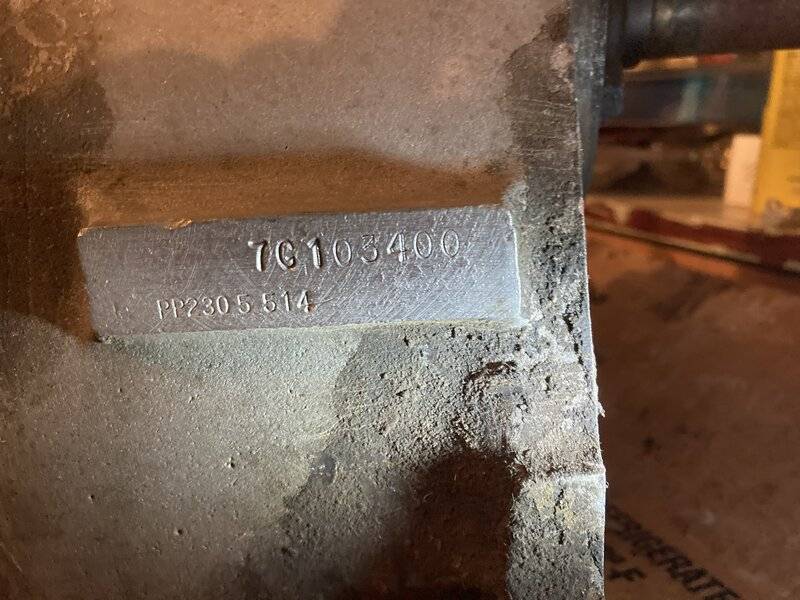

Using an aluminum case a833 OD transmission out of a 1975 F body.
I worked with Brewers Transmissions for the Hurst Shifter, shift rods and bushings and clips. The 1-2 and reverse rods are Mopar A body the 3-4 rod is a F body OD part.
Interesting thing about this transmission is it is stamped as a 230 three speed transmission on the s/n pad. Just another day in the Mopar assembly plant.
