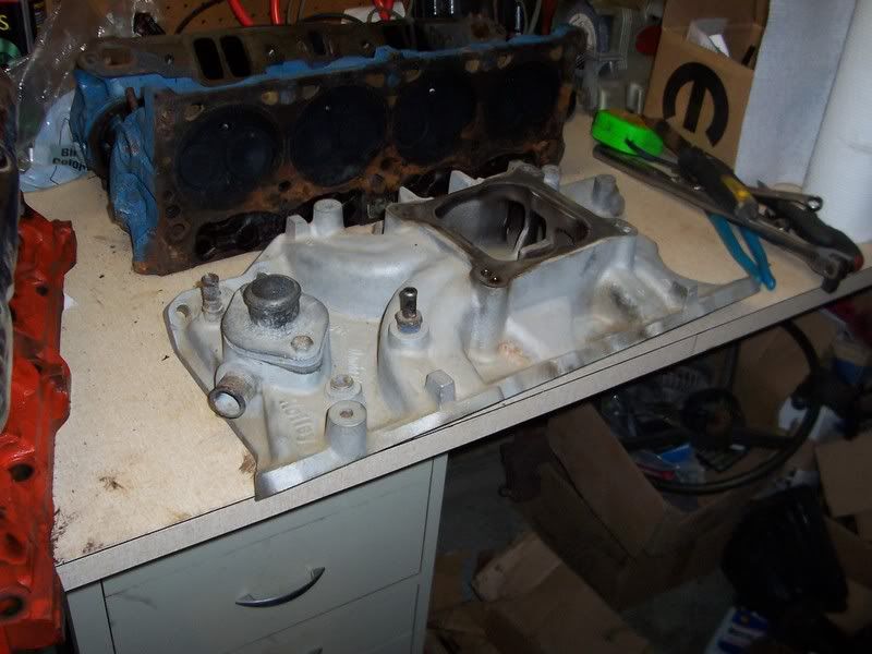

I had one that came with my 360 when I bought it. I never did use it...ended up selling it...but just for discussion sake, this is what they look like:
Yeah, that's what mine looks like.
I'm thinking maybe the goal of the small ports is to keep velocity up to help offset the low end disadvantages of a single plane intake? I can't imagine you'd want to give away too much torque with a 318.

Good picture there GoldDuster318, thanks for looking out and posting it up.
