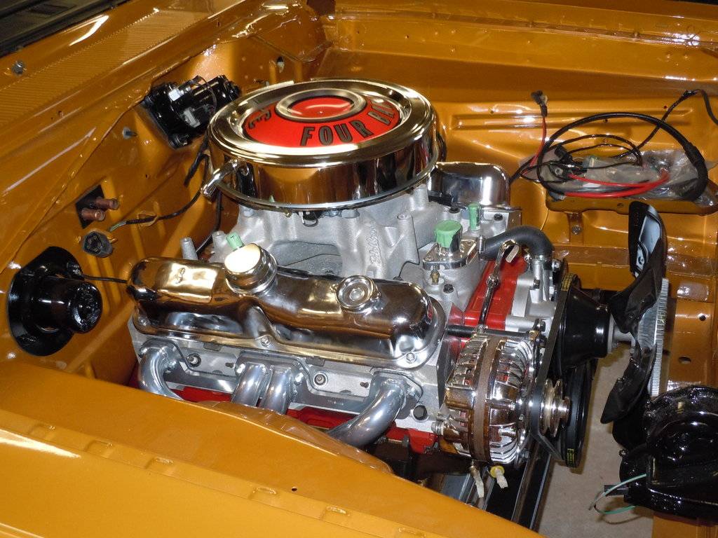

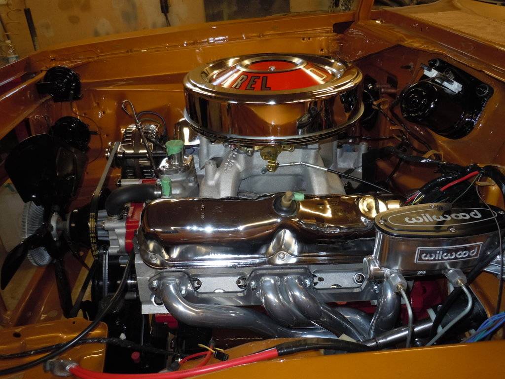

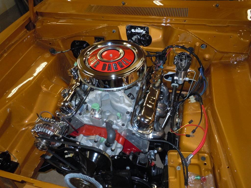

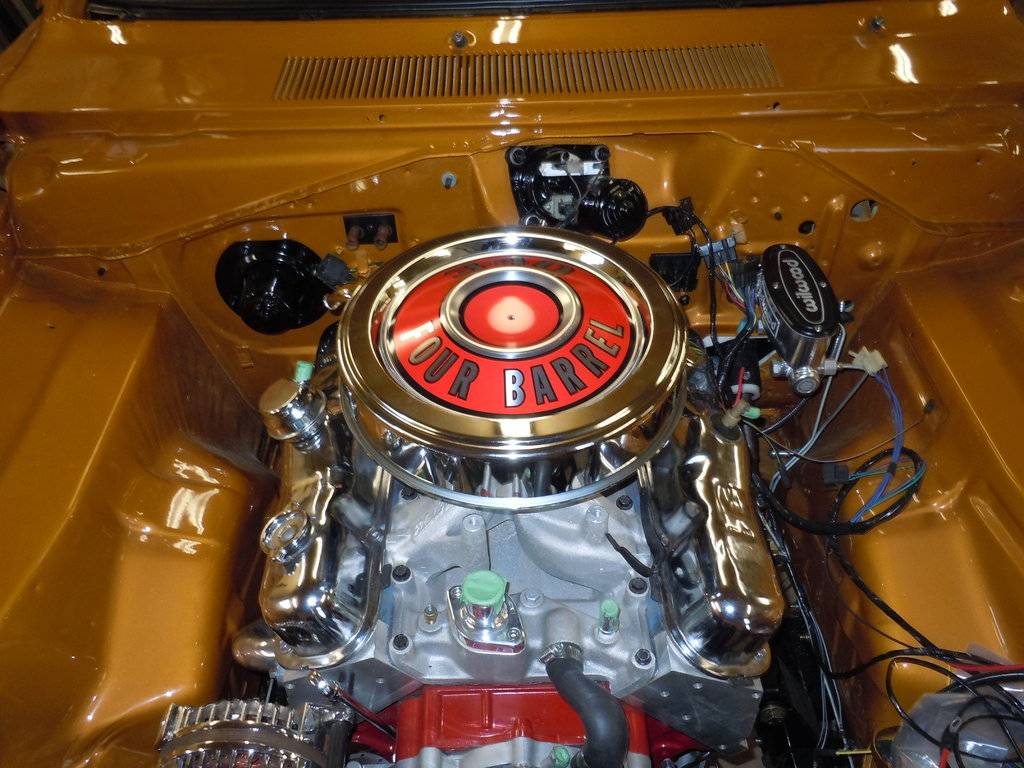

Supercuda just got her heart back!! Can't wait to hear it running.
Here's some engine pics. BTW, for those considering using RMS front suspension and k-member, I had to alter the Milodon oil pan a little to clear the steering rack. I'll post pics of the modification as soon as I can.
View attachment 1715082599 View attachment 1715082600 View attachment 1715082601 View attachment 1715082602
So I know this is an old post but I was wondering what headers did you use?
Hi Dragnut,
I used TTi Shorties. They look great , gave me plenty of clearance for steering and make spark plug changes a breeze. Also let me tuck my exhaust up closer to the floor pan with my 4-speed trans so no exhaust hanging down below frame rails.
Highly recommend TTI !!
