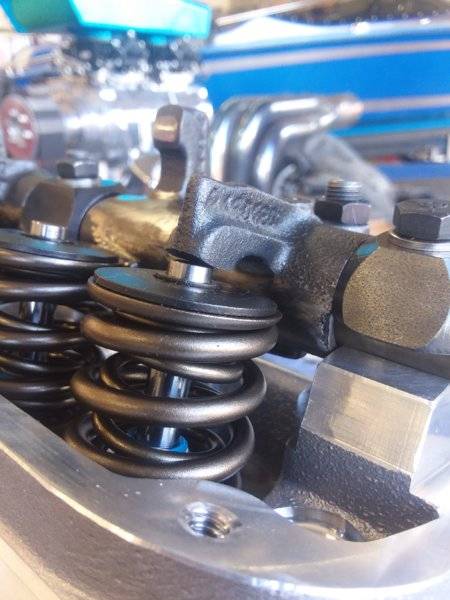

Did you say what rockers you have???
Please post up pictures when you get the B3 stuff. I should have done it but I didn't. I did take some pictures of the kit assembled but I can't find them.
TF offset the shafts a bit so I'm curious to see how much correction your stuff takes.

Just came in today!!
PRW 1.6
This is what Mike @ b3 racing put together for me...thanks Mike!
I was originally going to use a set of 273 rockers.
Mike didn't recommend that.
He was Great in explaining why the geometry would not be happy.
View attachment 1715338187 View attachment 1715338187 View attachment 1715338189 View attachment 1715338190
PRW 1.6
Very nice. That's the rockers I run. It's pretty good that TF moved the shafts back a bit. You didn't need nearly as much correction as I did.
Mike is a great guy. Everyone should be buying his kits. Cheap money for a great product that works and fits per application.
With the Edelbrock heads i had to use a round back alternator instead of the square back. That might be what you have to do with these trick flows too.
