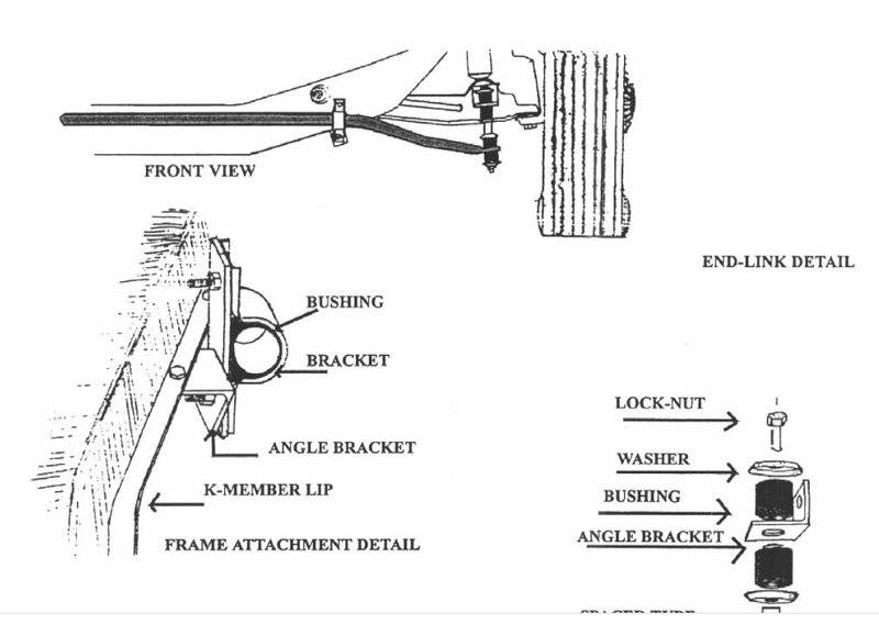

its the way the PST makes it for some reason. pretty stupid if you ask me.. i went with a hellwig bar. mounts like a stock one and comes with all the bracketes needed. even has control arm mounts that bolt to the shock bolt it needed.

Then I'm not going to worry about it too much. Going to try longer links and see if that helps. Looking at the thread you posted above, the post directly below yours looks exactly like my setup, with the same issue Im having. The only difference is looking at his bar where the end link goes through, it does look like mine might be upside down

Ok, now I get it, just never seen one like that! Not ever seeing what it looked kind of crazy to me. Thanks A-body Joe!
