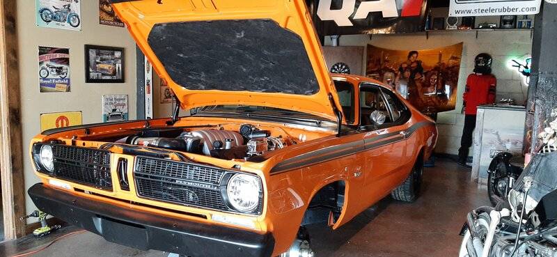

Got the wiring 98%completed.missing a glove box switch. The door jam switches just showed up,and I need to complete radio install. Otherwise it's on to fluids,setting up holley terminator x max, and fire it. Cosmetically I need to wetsand buff then spray my satin black,and lay out stripes. Once that is done I can install windows,and finish interior. We are getting close guys. Now I'm getting excited!

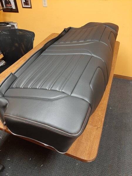

Seats done!

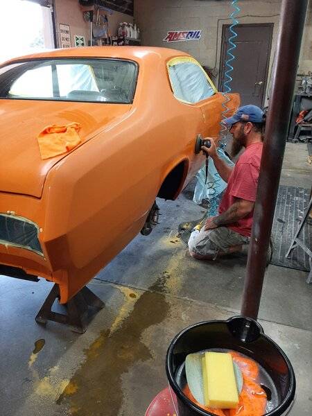

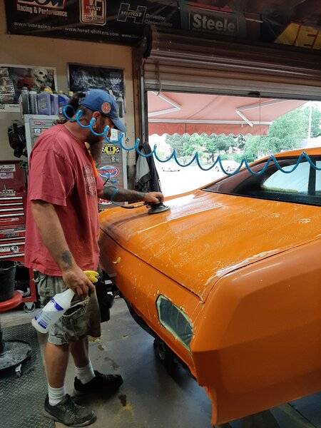

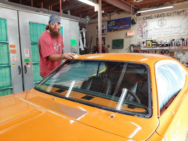

Start wetsand ,and buff.

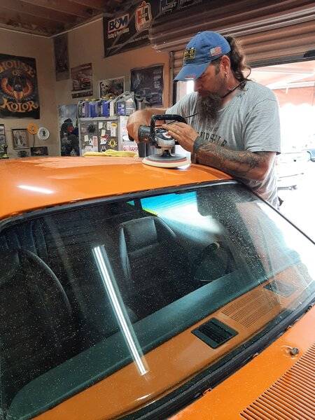

Buffing for days. KBS paint was so hard it took three days,and alot of trial and error to find right combo of buffing pad,and compound. It was a wool pad,and 3m yellow compound if your wondering. Then normal polish after that.

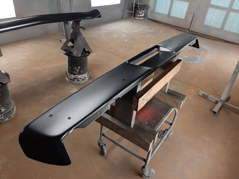

Kbs flat black paint. Laid down fantastic with no streaking or peal. Look fantastic!

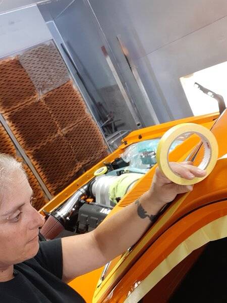

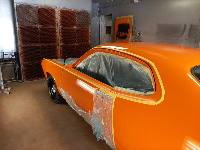

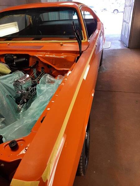

Now the satin black on the car begins with hours of meticulous taping. We wet sanded ,and buffed the whole car first. The parts to be sprayed black we left unbuffed for adhesion.
