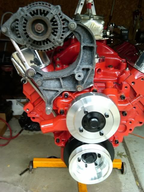

OK, so today I was playing around with an alternator and bracket.
Since I am a stubborn pain in the *** and I always get what I want, and just like everything else, I am determined to make the serpentine system work TOO. lol I had a problem though. This late model denso alternator (the only one that delivers the amps I am going to need) hits the valve cover. I am NOT cutting the beau-ti-ful valve cover, so we're working around it.
Please excuse the crusty bracket and alternator. It's been sitting for a long time. I took a magnum accessory bracket and cut the driver side off.
Driver side on a magnum supports the a/c compressor. It was a ***** cutting this thing since none of my wheels could get in there where it needed to be cut. So I busted out some oldschool and cut it with a hacksaw.:angry7: DAMN that was fun.
As you can see, I have a wrench in the far side holding the alt up. It's now a high mount.:cheers:
I am going to eliminate the serpentine tensioner and in the place of the wrench I am going to make a turnbuckle-style tensioner. This gets rid of the tensioner that will be in the way of the dipstick and just eliminates an ugly piece from the engine. Simplicity is the name of the game even though sometimes this whole thing seems so complicated.
And you're NOT gonna throw a serpentine belt. EVER. This is why I wanted to keep the rib belt.

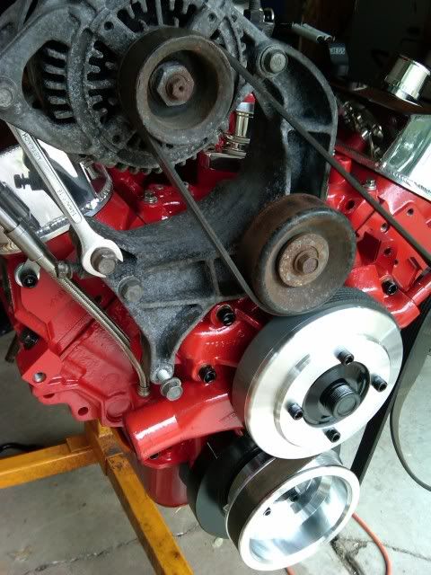

Some other pics....

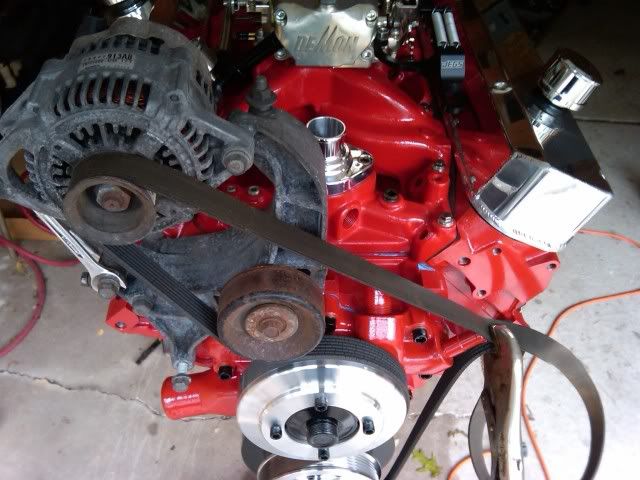

yeah with the belt routed like that I need a ribbed idler pulley. You didnt think I was gonna run that cheesy old thing did ya? I am however going to use that there bracket. When I am done massaging it youll think it was an aftermarket piece. I have a little bit of trimming and deburring, then I'll clean it and polish it up till it looks as close to the pulleys as I can get it.
making this turnbuckle tensioner thing is going to be interesting. I guess it needs to be forked on one end and a tube on the other end for the bolt to go through. Wish I could find a little coilove shock type thing that was strong like a normal tensioner. that would be cool, but back to reality.
More pics...

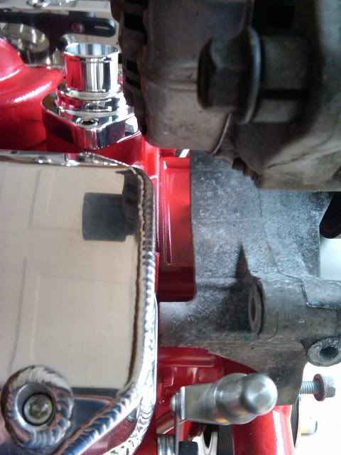

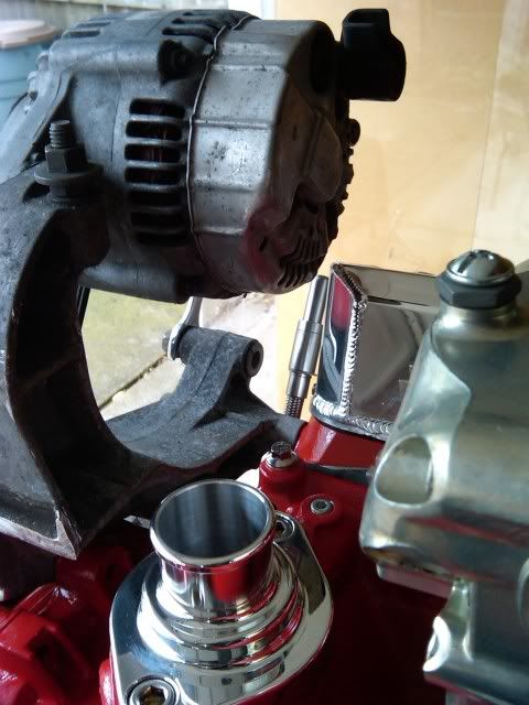

Clearance issue I was dealing with...now there's a little room to play with belt tension and stuff. Yes the hood will clear this.
And you know what? It doesnt really hide the look of the engine. I think cleaned up and polished with a new idler and alternator, this is gonna only add to the engine. people might hesitate before realizing it's a piece of the magnum bracket. Let them scratch their heads. That's what makes it fun!
Other side showing how much more room there is. When this is together I will be able to see and get to everything still without necessarily having to pull the alternator. This is a plus.
See that stuf with the nut on it at the top of the bracket? I forgot that A/C lines were up there where the alternator now is. Probably the same height the lines were. Very close. If you have a magnum engine you know how much you hate it if you discover a leak in the bypass hose, or want to replace a temp sender or fan switch screwed into the intake....well with this dealio you dont have to take CHIT apart to get to that stuff anymore. You would normally have to take off the alt, compressor, and the accessory bracket. Now you just do what you gotta do with it all together.:read2:

If you eliminate the serpentine tensioner, then as the belt stretches it get loose and slip. The tensioner is spring loaded and keeps the belt tight. With the serpentine belt, all pulleys have to be perfectly even with each other. Personally I go with V belts and save a headache
LOL I know the science/speculation behind it.:-D
But I am curious as to how the aftermarket systems using a rib belt aren't stretching and flying off the pulleys without a tensioner...
I had the same serpentine belt for over 10 years. Entire life of the truck.
I replaced the tensioner twice. The tensioner stretched. LOL But the belt is still fine.:cheers:
