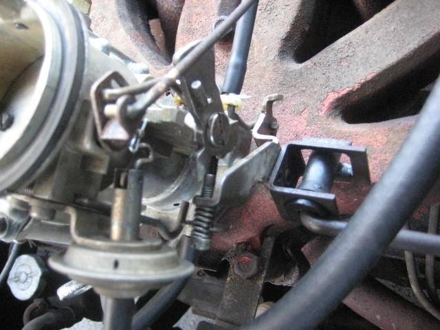

courtesy smokejumper69
attachment.php

I found the main problem, whoever owned it before me N rigged it upside down and backwards, i'll post a pic this evening, i noticed it this morning before work the rod is facing backwards and is stuck through the bug rectangle hole, with a piece of hose and a set screw bushing, and it works for **** !!!!!
I think the piece you want is part number 2128347 accelerator linkage insulator. Search by the part number on E-bay and occasionally one will come up for a decent price. AZMOPAR is parting a slant Dart and he may have a good used one....
Your a life saver, got home from work just now and jumped on ebay and ordered one, :)
Thanks for the pics pishta, its been a few years since i had a slantie this old, and didn't remember the position of the linkage, with your help i realised the assclown i got it from had the linkage in upside down and in the wrong side of the old carb, thanks
