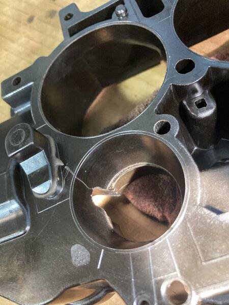

I decided to pull my trouble carb apart again while waiting for my rebuild kits. I think I found the problem. A crack by the main well. I filled the bowls up with fuel and can’t get a leak. It must pull fuel through the crack with vacuum when the engine is running.
Anybody know where I could get a reasonably priced replacement body?
Don't think that is a crack. It looks like the wells have been re-epoxied & some of the epoxy has run down the side of the bore.
Every TQ I have seen that has original epoxy, epoxy was white.
That's not jagged enough to be a crack.
It sure felt like a crack. I will clean it up with some scotch brite and see if the epoxy comes off.
