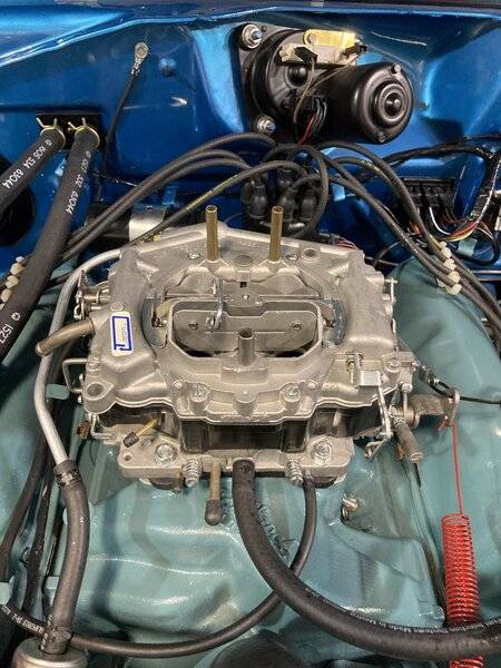

Recently started and broke in the cam on my 340 with a 750dp. I have a rebuilt Tomco Thermoquad 6138s from the 70s that has never been on a vehicle. I’ve wanted to try out a Thermoquad for awhile.
I don’t have the divorced Choke figured out or hooked up yet. I was able to get the car up to temp by holding the throttle around 1500-2000 rpm.
Choke wide open, and I let of the throttle the car dies. I have to go almost 4 turns out in the idle air screws to get it to somewhat idle. Idle screw maxed. When I slightly close the choke the car revs up and runs clean.
The carb is very responsive when I snap the throttle, but will not idle.
Where should I start? I didn’t find a vacuum leak around the base gasket or anything.

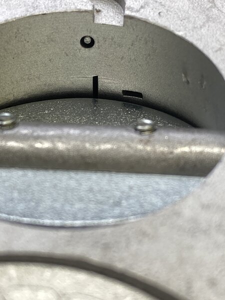

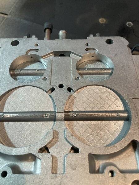

I flipped the carb upside down and the primaries have the transfer slot hidden with the idle screw at about three turns from seated.
The second photo is with the idle screw maxed out. Also one transfer port is cut with a taper and isn’t square.

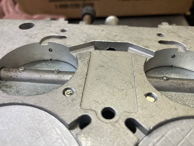

After I got the carb adjusted to run 850-900 rpm at idle and about 4 turns out in the mixture screws, I pulled it to look at the transfer slot. (Very very rich idle, and wanting to stall when starting in first and reverse. This is a stick car with 3.55s)
The transfer slot is barely visible. Probably just a square. I noticed when I was unbolting the carb that on the pass front of the carb, under the vase it was wet with fuel and a small puddle had formed on the intake. Same for the drivers rear of the carb.
