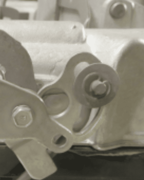

After adjusting the air valve it springs right back when pressed down with the linkage to the diaphragm disconnected, but returns much more slowly with it connected due to the friction of the linkage through the slot in the tab connected to the air valve. I noticed there is a sort of ring attached to most thermoquads here which I don't have. Is my case normal/ok?
This is the part I'm referring to (not my specific carb in the pic)

Pic in post #27. You need that 'ring'. It is a very thin washer that positions the connecting rod to the dashpot in the correct orientation.

No, you need the washer which is clearly visible behind the circlip in post #27. It is about 1/2" OD, hole fits the link. You can 'make' a washer using thin steel to the shape in post #27. OD is not critical & it does not need to be perfectly round. The purpose of the washer is to stop the circlip getting caught in the slotted arm on the end of the AV shaft.
