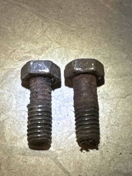

I want to get new ones as these just look nasty and missing some threads.

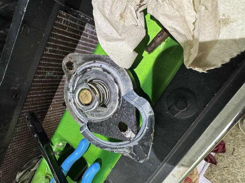

Here’s a few pictures of what I had.
What size socket to take them out? 1/2"= 5/16 thread....9/16 socket=3/8 thread.
Not to be a dick, but you're working on a 50-60 year old car, get a plastic bolt gauge, they're like $5, if that. If they're open holes to the coolant, make sure to seal them with Permatex hi-temp thread sealant.

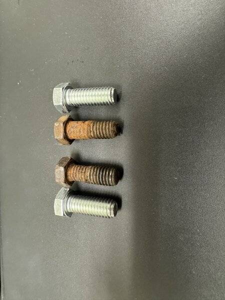

9/16, yea i will pick one up, probably needed of one for a while anyways, lol
the threads do not go all the way through to the coolant, that was another reason for asking bolt size was the length. i will match these up but was concerned about the bolts being to long?

Take the best bolt to the hardware store, lay the threads up against the new bolt, heads facing opposite directions. The right thread pitch will perfectly mesh with the threads on the old bolt. Get the same length and diameter. If they are only available slightly longer, add washers. Test fit the new hardware in the holes by themselves to see if the head will go at least as low/close to the intake as the neck flange is thick.

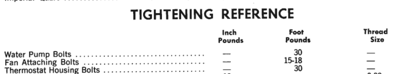

#5 - - so is the manual not correct in saying ft lbs?
My owner's shop manuals says the same thing, never used a torque wrench there. But I do use stainless steel washers under the bolt heads.
That goes with my recommendation to get all the junk out of the hole.
If you put the bolt in the hole and tighten it till it stops turning ( don't tighten too much or you can crack the manifold) measure the distance from the underside of the bolt head to the manifold.
Then measure the thickness of the t stat housing.
The bolt to manifold distance has to be less than the thickness of the t stat housing.
