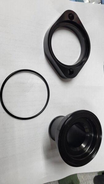

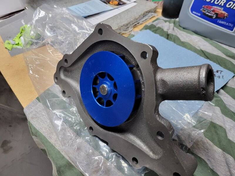

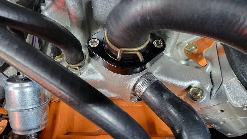

Real Gasket worked for me 3 years ago, but when I went to a Flowkooler water pump, it blew the gasket out 2 times in a row. I then changed to a Flashpower o-ringed thermostat housing, no leaks or blowouts since.

I tried tightening it down from light to too much, didn't matter. Sanded housing flat, filed the intake, never had these issues that I remember from working at a garage for awhile in the late 60's, early 70's. The o-ringed housing is the fix, I have never had to mess with the damn thing since. Torqued in inch lbs, don't remember how much, not out in the garage.
