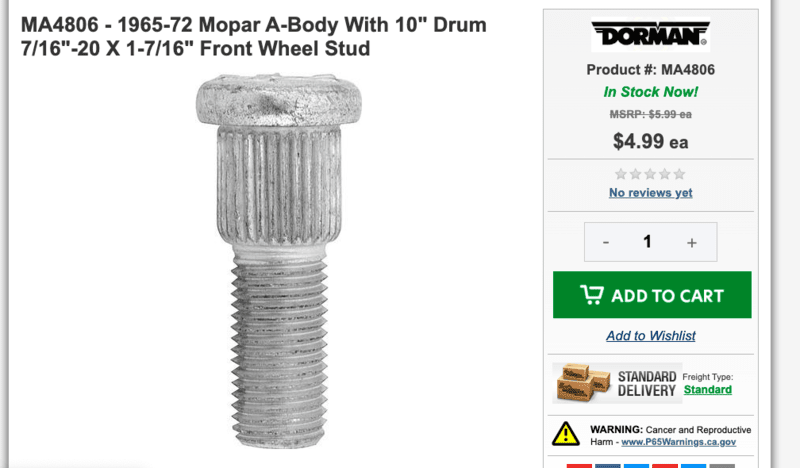

Now if I purchase the knurled lugs shown in post #7, I wonder if the new ones will be tight enough in all of the holes? I guess they could be spotted with a tack-weld or two without warping things out of round if necessary?
