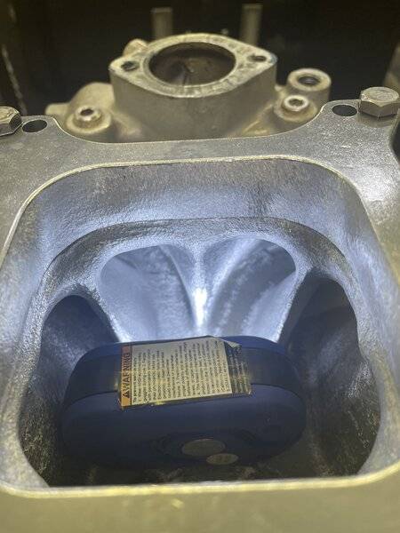

Since I’m porting again I bought myself a new light. I love my Boruit rechargeable headlamp and have two but I keep one in the race car for adding fuel and checking tire pressure. This one looked even brighter. Should be here early next week

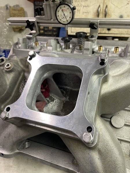

John, are you gonna flow the intake, before and after, or just attached to the head?
I already posted the stock intake numbers above on a set of Edelbrock heads I’m porting for myself. Numbers in far right column
Thanks, are the intake #'s the intake alone or with head bolted up to it?
As always and as i
Posted above bolted to the head. Before porting and after listed. I usually flow an internal runner because if I can get good numbers out of then the other runners even flow better.

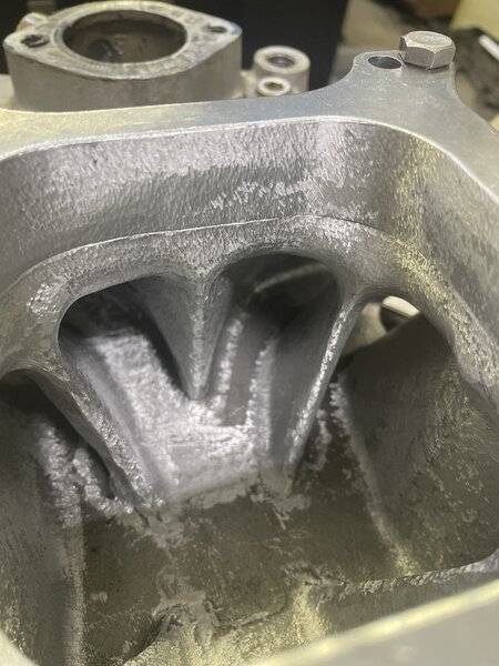

Well thanks to Rat Bastid and turning us onto Killer Carbide burrs I got all 8 roughed in by 8:30. These burrs kick butt and are a major time saver. I did 95% of this work tonight with a 1/2 single cut burr and I used to HATE single cut burrs. I Dont know how to tag him but if he sees this thank you Sir. I will be placing another order for some 3/8 headed burrs soon.
