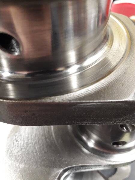

Maybe i'm off base here but, you said the Rear Most thrust bearing.........If that's the case then it would NOt be from excessive pressure from the rear of the crank pushing forward.
With that picture i can tell which side is the rear part of the crank.
in the pic the upper side is the rear thrust surface.
Only going by the photo, but the journal thrust surface looks rough. Some of the early Chinese cranks had quite roughly finished thrust faces & were wiping out the bearing.
yes, it is rough - because it´s worn now. the other side is fine, just as it was when it was installed.
Thanks guys for your opinions, will call some machine shops to see if this is repairable - don´t know if this can be welded and ground back to original specs. Otherwise it should get a new crank.....did not have this on my to do list, so it hurts a little.
For a crank to turn purple,gold or blue only on the one side of the thrust, there was a forward pressure involved. There is something not right regarding the torque convertor or how it's connected!

Seen that on a deal of mine. Ended up the convertor caused it

I also think that this damage started with a damaged torque converter and got worse over the years (built it in 2012).
I have had mine fixed at the machine shop that ground the crank. They may or may not want to do it but can recommend someone to do it. Kim
negative feedback from several machine shops....repair work seems not so familiar here. Waiting for some feedback regarding a new crank, balanced to my specs from some U.S. Suppliers.

the Crank was already pushed forward so far that the main caps show signs of contact to the crank.....damage could have been much worse if i did not catch it now.
Have you thought about rolling in a new bearing and see how much clearance you have.
I'm going to guess, and say the ruff texture on the crank is no the crank........but bearing material stuck to it.
You may need to remove the crank to clean it off.
Steel crankshaft is way, way stronger then a bearing.
If it was mine i would take it to a crank shop to have the journals polished(including the thrust) throw a set of bearing at it and call it a day.
that´s what i thought first, crank material must be way harder than the bearing, new bearings are already on the way.....but it´s really worn into the cranks thrust surface. I´ve torn it down completely today, will make a better pic later.

Nope, unfortunately not only bearing Material :-(
I can see scratches, but that wouldn't bother me if the outer surface was smooth.
Looking at the brg halves in post 42, I'd say you have more than a thrust issue.
The brgs are wearing on the edges, indicating dirt under the brgs or more likely high spot on the crank journal.
thanks, but i think this comes from the axial movement of the crank. the cranks radius was pushed into the bearing, that´s why the (rear)edges are more worn.
