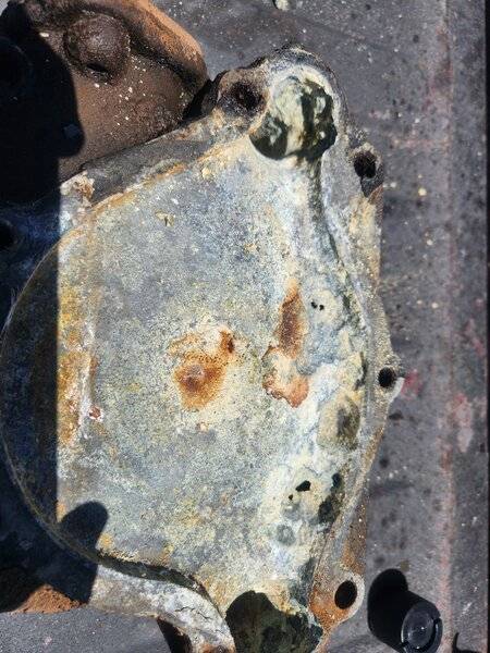

Short update before I get back after it. Last night after work I got most of the accessories and brackets off. Bottom radiator hose was chock full of corrosion and jelly-like congealed old antifreeze at the water pump connection and the thermostat looks like it is welded shut with rust. It obviously sat for longer than advertised. Doesn't help when I picked it up the radiator cap was left on the battery tray so the system was open for evaporation. It is going to be a good day.

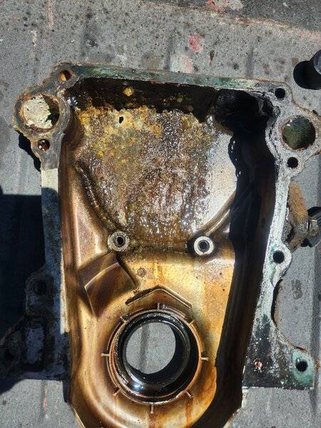

The cover on my 273 started leaking it was a pin hole. My said put a little JB Weld and it will be fine. I couldn't do that and I pulled the cover. Glad I did, the inside looked like the surface of the moon. The inside was heavily deep pitted all over. Electrolysis is taking place and attacking the weaker metal the aluminum. If it was and outboard motor at a dock you attach a zinc tab. I just added a couple of extra grounding cables the engine along with a kill switch. We'll see how that works.
Once my coffee level is adequate I am sure I am going to find the same thing you're describing once I get the water pump off based off of all the corrosion I am seeing in the inlets and outlets. I am glad I reached out and didn't just do the gut redneck thing I usually would and JB Weld it. It would have been a very short lived fix. Assuming I can actually get it running once I can get it to hold all of its fluids in...lol.
I am surprised at the astonishment at the reaction of aluminum & water. After 40 years industrial maintenance I see an aluminum part I expect to see corrosion, it's just the nature of the beast. This is one place in engineering that gm had a better idea sheet metal timing cover & water pump separate.

Dang good I tore into this. Not only did the inside of the water pump look like this.

The iron behind the timing chain cover was clean of water for the most part. There was no condensation droplets. There was the smallest bit of rust on one tooth space at the very top of the timing chain on the cam gear. The front wall of the motor is completely free of rust. There was still wet "oil" on the end of the oil drizzler beneath the cam gear. After a quick spray with carb cleaner to wash any residue away and to clean the gasket surface, you would never guess there was a water/antifreeze leak into that area. Of course the timing chain stretch tells me the 99k+ on the odometer is at least 199k but we are going to pretend we didn't see that for the time being.
That's why I am thinking that it corroded through while sitting and not ran that way. Wouldn't you expect that id ran with that sort of leak that the hot preshurized water would have washed all of the oil off the front of the motor and then I would have found a rusted mess in there?
