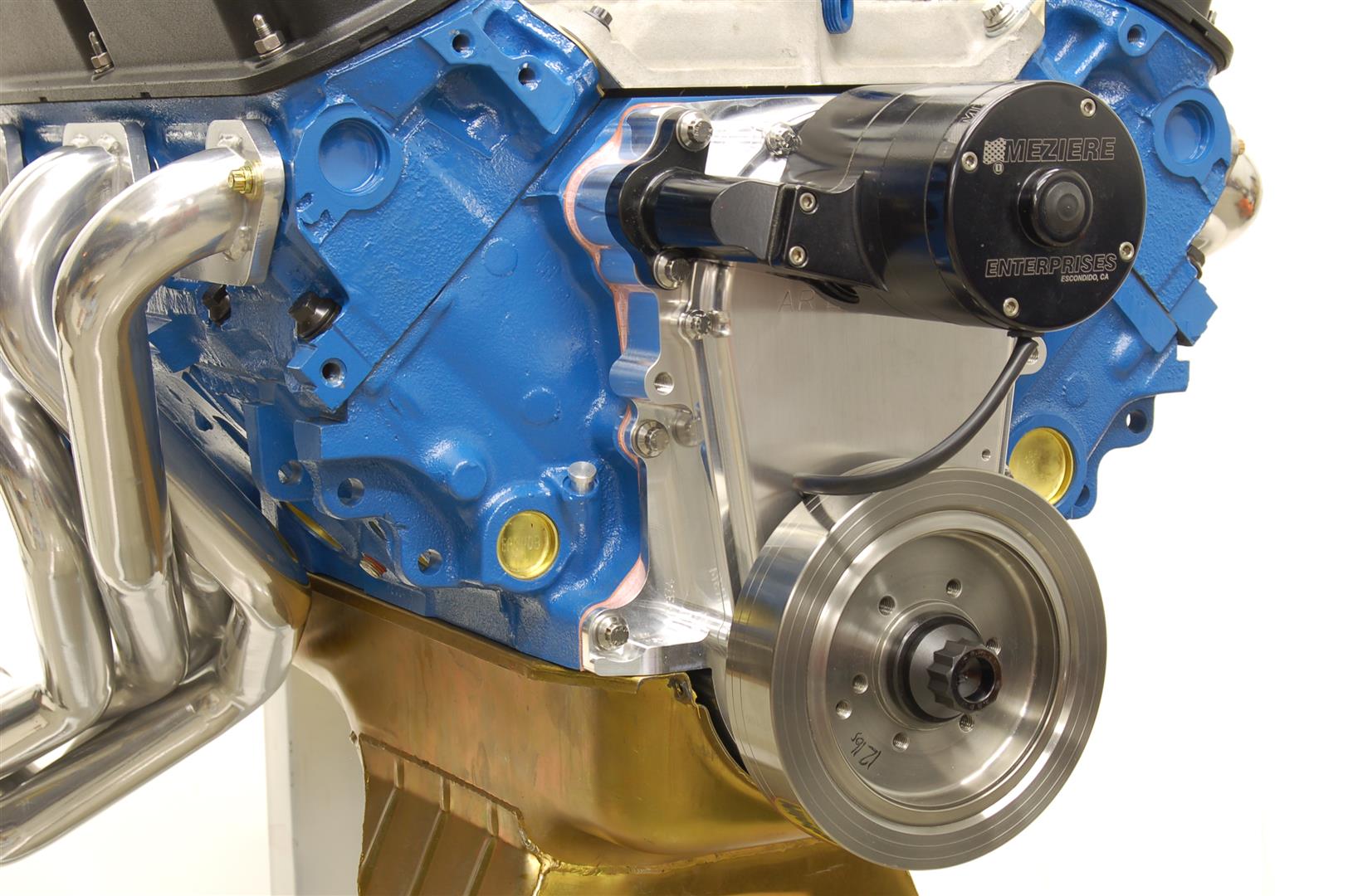

If you use a two piece timing chain cover you won't have to mess with the pan seal.
sb-timing-chain-cover
Here are some pictures of a two piece timing chain cover for a small block
I saw something new this morning. That would be a great way to have a chrome timing cover ( If one wanted that GM look ). Thanks for sharing.
The two piece cover isn't for looks, it is so serious race guys can change the camshaft quickly. If you use a remote water pump the job goes even faster. The engine can hang from the motor plate in the car during the entire operation. Just pull the damper, pull the chain cover and swap the camshaft.
does that take a big block style water pump ?
SB electric pump or use a remote pump. I recommend using a remote water pump whenever possible. The remote pump saves a bunch of space and it gets the water pump away from the heat and vibration of the engine.
