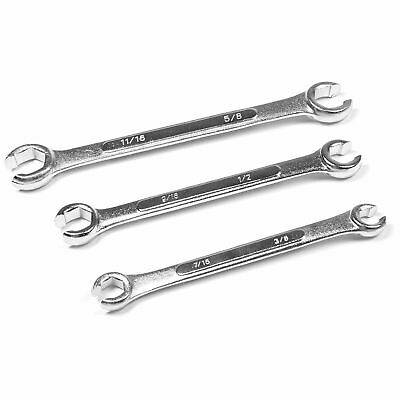

Yes, can you modify a cheap wrench to work? Have never seen a situation I couldn't fit a wrench. How about removing the crossmember and dropping the tranny slightly to get a wrench in there?
Are you using a line wrench?
Inverted flare or tapered pipe thread? Got a picture. Yes, the proper tool should work.
